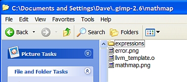

OK, I tried your trick and that got rid of the duplicated 2.6 folder from my F drive. I placed the "Mathmap" folder from the zip file in my user/2.6 folder and the MM I edited the preferences to point to the new "MM_Add_2_plig-ins" folder from the zip file in my user 2.6/plug-ins folder. Mathmap shows up under Filters>Generic>Mathmap>Mathmap but then there is nothing else there. No guts just the shell.
By "Plug-ins folder" Which one did you mean...user/2.6 on C drive or gimp 2.O on F drive?

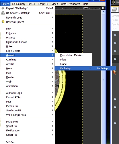

Clicking MathMap/MathMap a interface show up ?
Then if you click "filter" tab a filter list show up ? you may expand the list and chose 1 ?
and last if you click "user value" tab you see the controls for the filter ?

Yes it shows up alright but there is nothing in filters or an other tab.

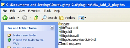

That too weird.
Maybe some download problem?
Open the mathmap folder in the user profile (not in plug-ins) did you see a "expressions" folder there ?
and a lot of subfolder inside ?
Another thing you may try is copy the CONTENT of the MM "share" folder (is in the MM subfolder inside plug-in ) and paste inside gimp/program files/share.

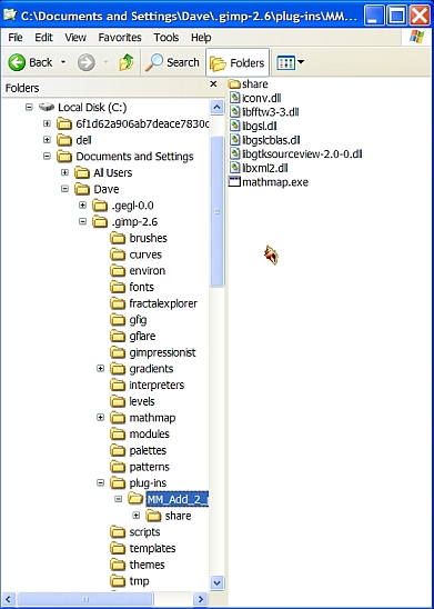

Rod,
If you look at one of my posts above that shows the preferences paths you will see that it points to the C user 2.6 where the MM_Add_2_plug-ins is located. The screenshots below shows the tree where everything is installed. I never did get my previous question answered by PC regarding which plug-ins folder it was supposed to go in. Anyhoo...you can see how it is configured at present.
You lost me at "batch file". I'm not quite that accomplished to be able to do that. You'll have to walk me thru it if we can't get this solved otherwise.
I just drilled down into every folder and notices that there was nothing in the expressions folder. PC said there was supposed to be a lot of subfolders inside. What am I missing? While I'm waiting for an answer I'm gonna check all these different zip files and see if the "Expressions" content is in there somewhere.

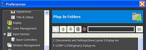

PC - I did exactly as you said and moved everything to a backup folder on my desktop and started fresh. I downloaded the 2.6_MM.7z zip and placed the folders exactly as you said. I restored the original default path in preferences as well. Now Mathmap doesn't even show up.
Please look at the paths at the top of the folder screenshots and tell me if that is correct and if the paths in preferences are both correct.
NO are no correct
You did well to restore the path

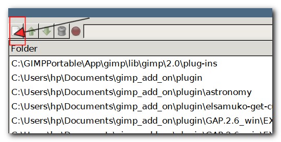

But you didn't add the third one, the new one for the MM folder , remember 2 are the DEAFAULT path but you may add as many you wish
Please look the screenshoot....First click the icon folder indicated by the arrow then do as you did before

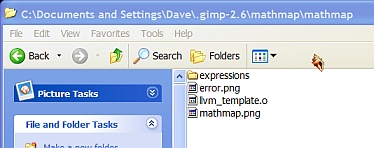

From your screenshot:
c:\Documents and Settings\Dave\.gimp-2.6\mathmap\mathmap - No
(unnecessary sub - mathmap)
Yes: c:\Documents and Settings\Dave\.gimp-2.6\mathmap
You may also like:
mathmap:
expressions
plug-ins:
share
iconv.dll
libfftw3-3.dll
libgsl.dll
libgslcblas.dll
libgtksourceview-2.0-0.dll
libpng12-0.dll
libxml2.dll
c:\Program Files\GIMP-2.0\lib\gimp\2.0\plug-ins\
mathmap.exe

Take the MM_ADD_To_Plugins folder out of there and ONLY place what is inside that folder in the plug-ins folder. :)
OR open Gimp and create a path to it from Edit/Pref/Folders/Plugins
Easier to just remove that folder as i said above though.

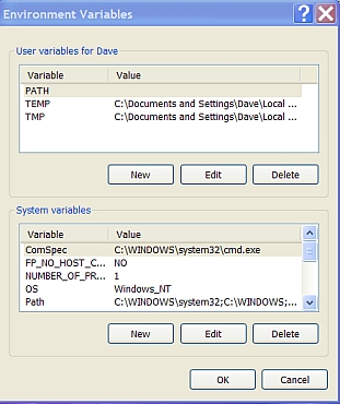

Draconian you have 1 user gimp-2.6 folder that Gimp recognizes.
Do this - go to start/control panel and click system/click the advanced tab/click environment variables
Look for a VARIABLE in the bottom list named HOME
To the right of that variable is the VALUE or PATH that is your home directory which Gimp looks for.
That path i am sure is C:\Documents and Settings\Rod (Rod being your username)
That is where Gimp Directory Two is placed on Gimp Load.(if its been removed or deleted it is created new - default)
There are two confirmed places you can place the CONTENTS of the MM_ADD_TO_PLUGINS folder.
1) F:\Gimp-2.0\lib\gimp\2.0\plug-ins
OR
2) C:\Documents and Settings\Rod\.gimp-2.6\plug-ins
The mathmap folder COMPLETE has to go into the C:\Documents and Settings\Rod\.gimp-2.6 folder.
That will work for you i am positive. :)

UUUGGGHHH! It's 5:00 am and my eyes are still blurry.
MareroQ - I got rid of redundant "mathmap" sub-folder (had a feeling that wasn't right but that's what happened when I unzipped the files, even after selecting which files I wanted to unzip. Did it twice to be sure)
Rod - I got rid of the MM_Add_2_plugins folder and only placed contents in C\:Documents and Settings\Dave\gimp 2.6\plug-ins folder. I checked the Environment Variables and didn't see anything called "Home" but I think it's OK as is.
I looked at the preferences and they seem to be ok (unless I'm still to sleepy to see anything)
I opened an image gave it an alpha channel went to mathmap and selected several items but when the window came up the preview was blank(looked like an alpha layer). When I went to "Drost" I got the black preview window and all these little square thingys. Your turn guys. Your patience is greatly appreciated and we are making progress it seems.

C:\Documents and Settings\Dave\.gimp-2.6\mathmap <---- remove this (mathmap folder directory isn't a plugin)

@Draconian
You did again :hoh , again you installed the 2.7 version of MM instead than the 2.6 :gaah
How you can confuse 2.7 with 2.6 ? .could you suggest something i may do to minimize the chances that someone else will do a similar confusion ??
The GOOD NEW is that will work the same even if basically for pure luck:
the 2.7 pack is compatible with 2.6 (NOT the contary)
... BUT you should take care of similar details because similar unexpectable errors make very difficult for others help you

Drac the path you added to mathmap folder in the plugins path selector is not viable (Gimp doesn't understand it) Remove that path please. :)
Done!
I don't understand what it is that you see in the screenshots that tells you I downloaded the wrong zip. can you be more specific. The file I downloaded from your previous post here was this one:
2.6_MM_32bit.7z
I have checked the contents of that zip against the files on my computer and they look the same to me.
What is it that you see that indicates a 2.7 install?
