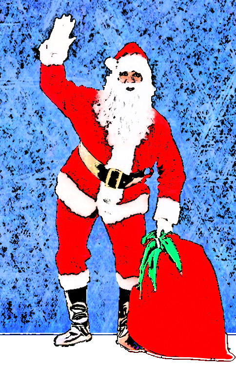

Argh!!! I ran the wrong script for the Santa. The one below is not the result of saulgood's tooninator script. - O :oops:
I got a Santa image and a background image from stock exchange. These are thumbnails of the actual images. After I ran the cartoon script, I cleaned out the white bg.
Image.....Image
Disclaimer: This image is NOT a result of using saulgoode's tooninator script.

Result of saulgoode's real tooninator script and I like it much better. Thanks saulgoode.

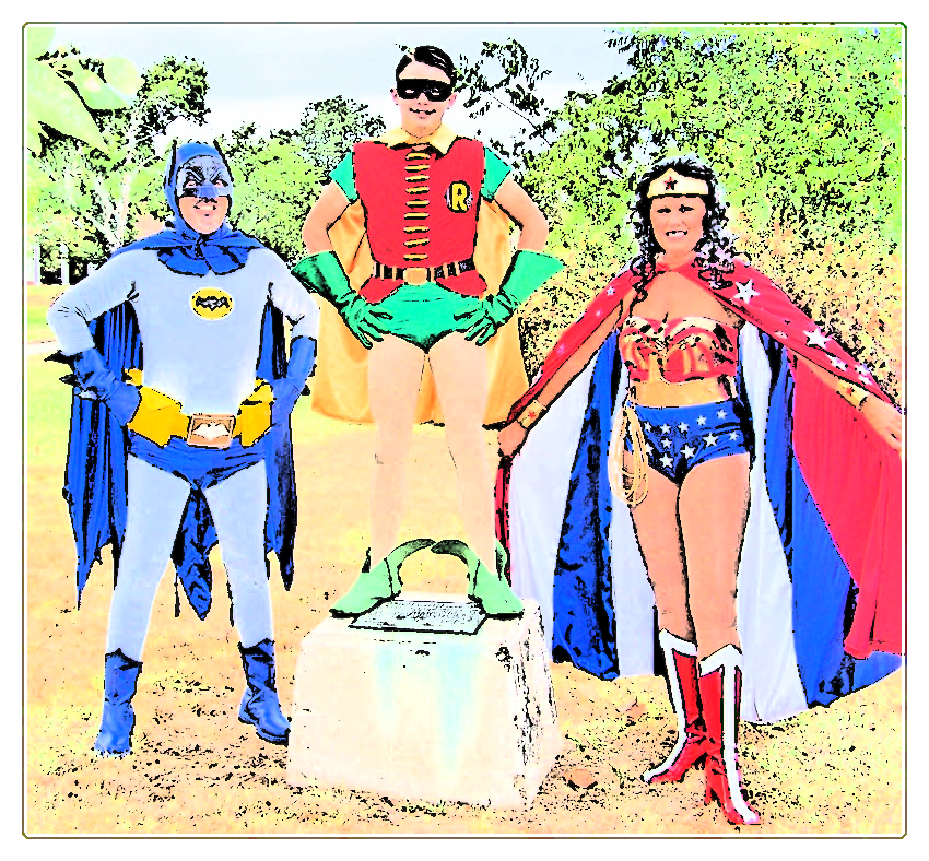

I like the resulting border when you add an alpha channel to the image, add some canvas and then run the script.
Links to original images:
http://blog.costumecraze.com/gallery2/d/1276-2/dc_1.jpg
http://www.lolcostume.com/pictures/Mermaid_Costume.jpg

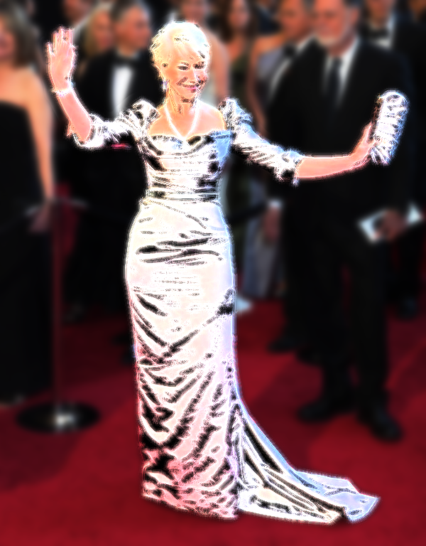

I have this image of the fabulous Helen Mirren....so I made a matte around her, blurred and darkened the people behind her and then ran the toon-inator script. Merged the layers and ran that Rodilius filter (numbers way down). it added a bit of glow to her. she has plenty of internal glow anyway.

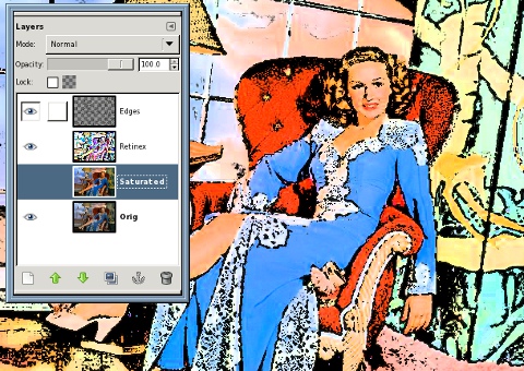

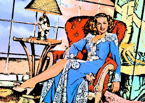

2-ton wrote:
best cartoon script I have run across! Wondering if there are any hints to prepare a pic to be cartooned that can tweak the results either to be more or less colorful, or have more or less black lines?
One of things I've noticed is that the amount of black is inversely proportional to the amount of saturation in the starting image. This can be effectively used by running the filter on a duplicate layer that has been desaturated to obtain more black shadows and lines, and then hiding/deleting the duplicated layer.
Or conversely, increase the saturation of the duplicate to reduce the amount of black.
You can use the Value Propagate filter set to "Make more opaque" to increase the thickness of the black edges a little (it can get ugly if done to excess).
As far as changing colors, most any color adjustments made to the original layer after running the filter will adjust things as expected. In the following image, I adjusted the hue and saturation a bit with the Hue-Sat filter and also used my Quantize filter to smooth out the colors even more.
