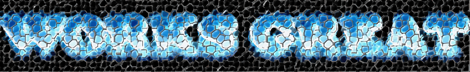

Works great Graechan. Just thought of some possible additions. Is it posible to have a way to ask what type of mosaic form (triangles, octagon/squares, etc.) and both size and percent distortion of the mosaic blocks. Not sure if the amount of spacing matters, but why not add that too. Just curious. Not sure how easy it would be to implement these features interactively. Also have a check mark to either have grout or transparency (so I can add some addition tweaks to the cobblestone via other filters). Just some future enhancements maybe. :)

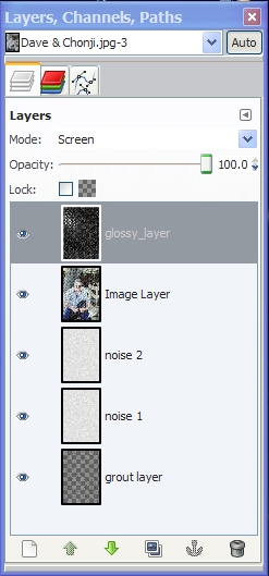

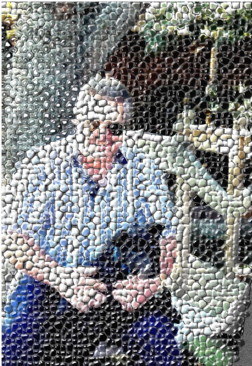

Great script Graechan! I made a few tweaks to my layers. Don't know if you want to incorporate or not but here's what I did.
1. Isolated the grout on a transparent layer and gave it a 7E7E7E gray color, duplicated it and blurred the dup at 5, bumped the original at 12 (inverted). Then deleted the blurred layer.
2. Made a new white layer inbetween the grout layer and the image layer. Filled it with RGB noise @ .50 and set the layer to multiply then duped the layer to give it a gritty texture.
3. Duped the image layer and blurred the dup at 15, bumped the original image layerat 7. (deleted blurred layer)
4. Did an alpha to selection to the image layer and applied Glossy Stroke 3D set to Fill at 1 and turned the opacity of the shadow to 0. deleted all the glossy stroke layers except for the one named "glossy layer", then did a simple Blur>Blur on the glossy layer.
I got a very shiny look almost like glass tiles and a little better recessed look to the grout. I got a little bit more than I wanted in the upper right hand corner of the pic but I still liked the results. You can see the grout texture layer really well in the lower right corner.

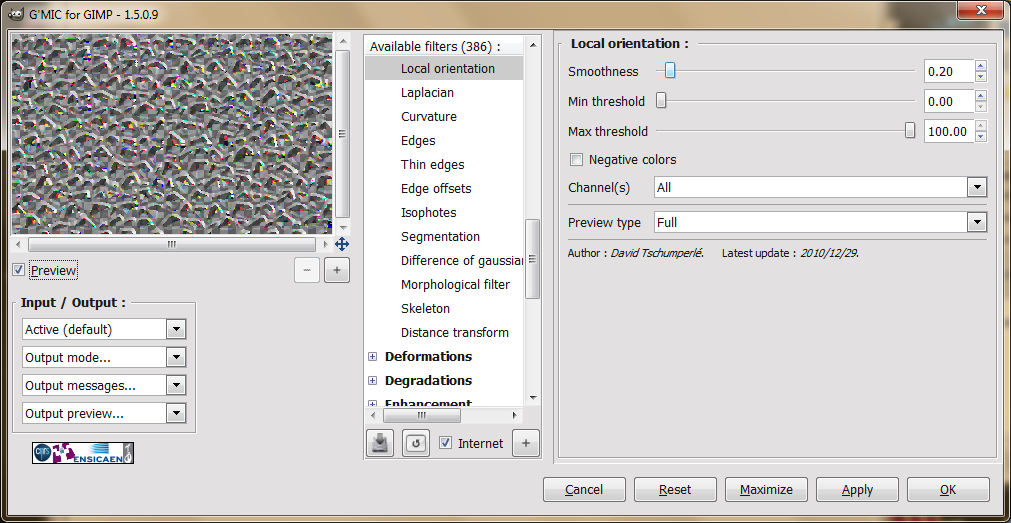

Hey Graechan. If you really want to shine the cobble stones, you can always run G'MIC's local orientation with a slight increase in the Smoothness slider and set it to Grain Extrace with a copy of the stones on top set to color and another copy above that set to light with adjusted opacity to taste. See XCF (7-Zip) file for layer details. Note to merge all visible before applying the grout. :)

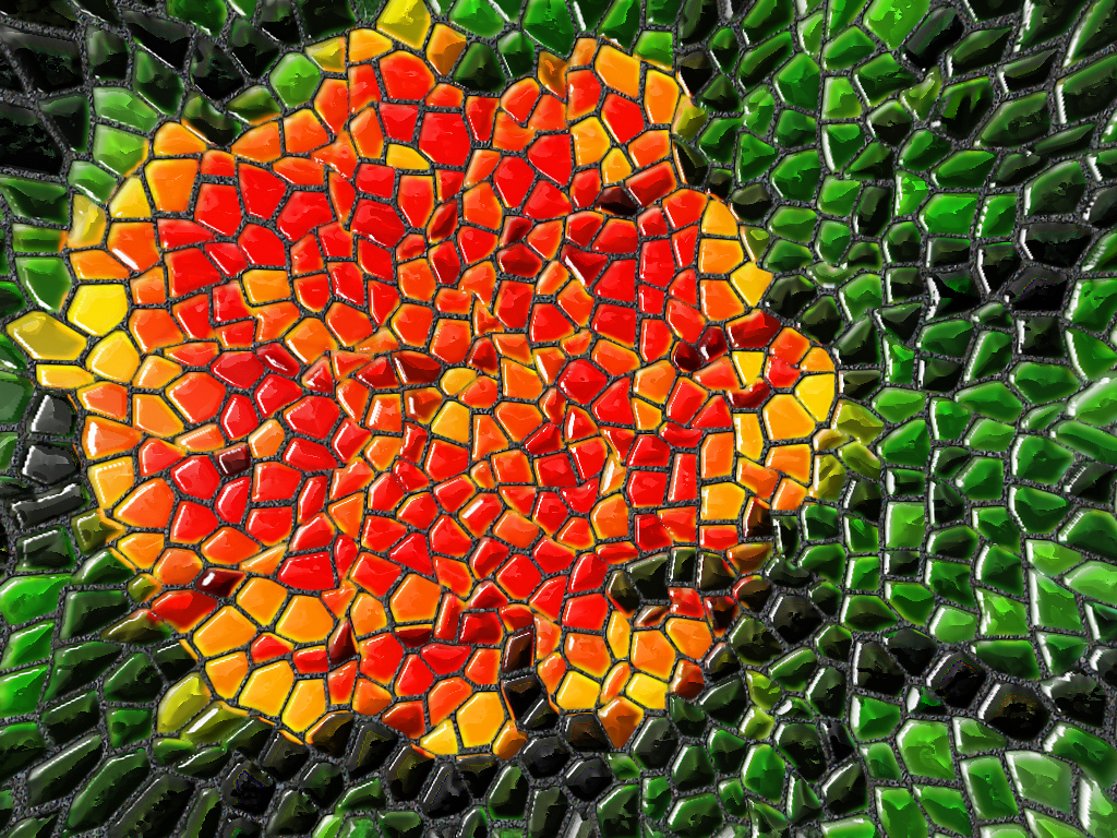

OK Lyle, I give up. Been working on this for about an hour and a half now and I can't figure out what you did to get the tiles to look so flattened on top. What's up with the rings? You keepin' secrets again? :hehe
This is my latest and greatest couple of attempts.
I'm really having fun with this Graetchan! To get the grout like I like it, I alpha to select the image layer and go to the grout layer and delete the selection therefore making a sort of grout "lattice" layer. Then dup, blur, & inverted bump. This time I added the original image above the selection blur layer in overlay mode. Also did a Layer FX bevel & emboss and put them at the top. Then ran the glossy stroke 3d. I also tried to immulate Lyle's image and ran GIMIC's gradient Norm @ 5 on the image layer and place it under the original image layer. I just can't seem to duplicate what Lyle did.

LOL; to create the grout, I dupped the stones and, on the base layer, ran G'MIC's Gradient Norm preset adjusting the Top slider until I got the ring effect; might have done this step twice; can't remember in my half-heimerz state. Also, I like the reflection effect that you did for your result; nice added touch. :)

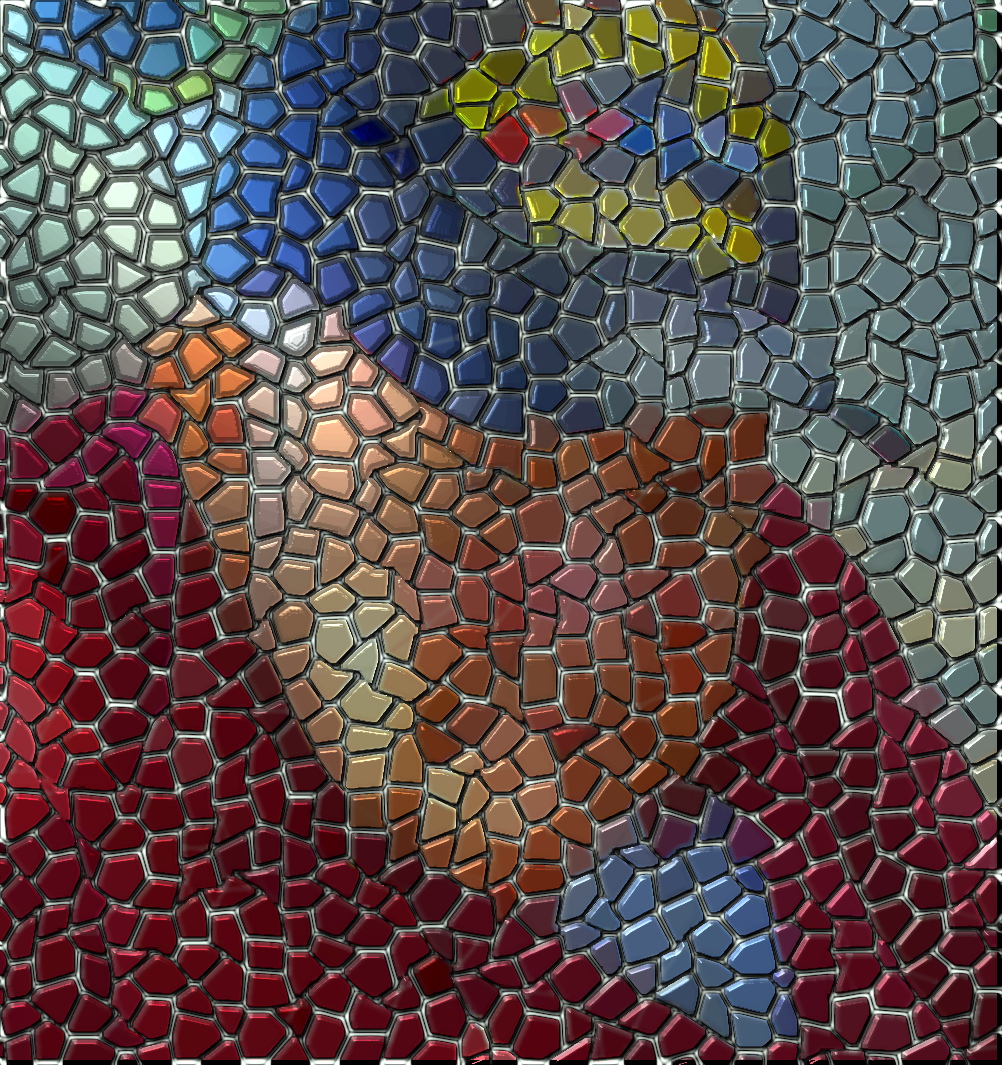

Well I've been busy to guys, the output from the script now looks like this.
I hope you can see what chages were made.
I used the dreaded lighting affects filter (and yes I never gave up on it).
