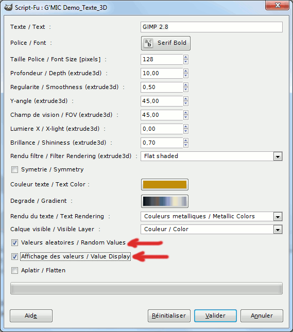

File > Create > Logos > G'MIC Demo_Texte_3D...
Here is an example configuration for testing (Make several attempts to get different results) :

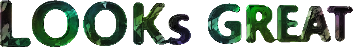

Looks great samj but the G'MIC step is really slow and it looks like it refreshes the G'MIC script each time it's run. Not sure how to bypass that part. :)
