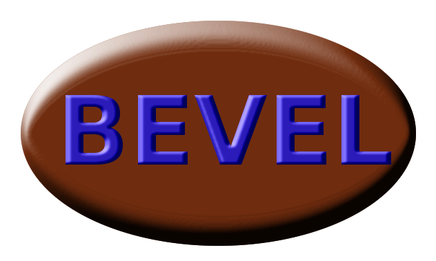

I know it's been a while, but I just thought of my old plugins, and I figured to update selection bevel. It had an annoying bug that crashed it if the width was 1px, and the rendering code had become needlessly complex so I simplified it. It was easier than I thought so it didn't take long.
While doing this I also added a new, nifty feature. You can now set the bevel width and height independently: this means, that the bevel's top and bottom edges can be different width than the left and right edges.
Well, picture says more:
Download the script from the registry here: http://registry.gimp.org/node/25199
The plugin installs itself to: Filters > Distorts > Bevel
If you have earlier versions of my selection bevel, you have to remove them first. Remember to set the x flag if you're on Linux.

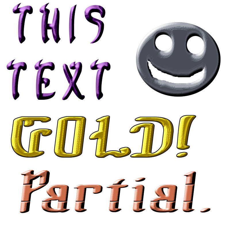

Here's another example of things Selection Bevel can do now:
 Post subject: Re: Update of selection bevel
PostPosted: Tue Dec 24, 2013 12:36 pm  (#6)
Posts: 16158
Fantastic examples. That smiley sure is frightening. :lol
