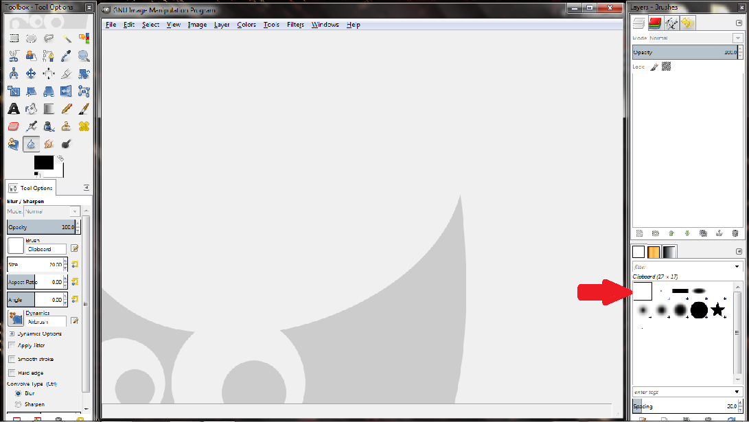

After downloading the zipped file (I have attached ofnuts' file below) I copy pasted the addonCollectionManager-tracing.py file from the folder into the Gimp plug-in folder, which can be found at C:\Users\Username\.gimp-2.8\plug-ins
After I had moved the file into the plug-in folder I then went back to the Gimp folder (C:\Users\Username\.gimp-2.8)and created a separate brush folder named brushes_storage. I moved all the brush files and/or folders from the default brush folder into the folder that I had just created.
After all of the brushes had been moved, I opened Gimp.
I then navigated to the Brushes Dialog box.
I right clicked on the square in the brushes dialog box, then selected Brush Sets from the menu.
After selecting Brush Sets from the menu, the Brush Select Manager window opened. I clicked the box next to the name of the brush sets that I wished to use.
The brushes were then loaded and I was ready to go.
