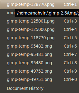

I guess my next question (couldn't find the answer in my Python manual) is when using a Linux path, such as seen here:
# Command line
path = "/home/mahvin/.wine/drive_c/Program Files/XnView"
command = path + "xnview.exe " + "\"" + tempfilename + "\""
Wouldn't the command path (see highlighted) have to follow the same Linux conventions? I tried making backslashes into forward slashes, but that threw str errors.

OK I found a few other things-
The whole command line needs to be quoted if it has spaces, and the popen should have the args broken out.
Try the attached.
mahvin- I'm just using the built in temp location gimp provides. It is likely that the unix path is not accessable inside the wine environment. http://www.winehq.org/docs/winedev-guide/x3016 gives some details.
I'll try setting it up under ubuntu and see, OK?
