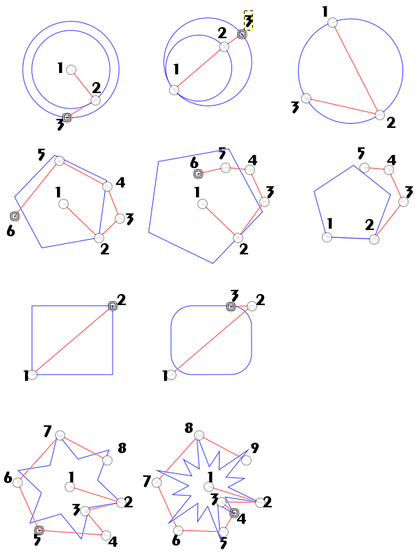

I don't like GFig (it cannot create paths...) so I use shape-paths, but I don't like entering all that data by hand. It's much easier and faster to indicate where your shape should go with points on your image, so to answer this I wrote here path-to-shape. You can draw:
  • a circle given a center and a point on the circle (if more points: more concentric circles)
  • a circle given two points on a diameter (if more points: more circles with a common point)
  • a regular polygon given a center and a vertex (the line between them is a "circumradius"), the additional points on the stroke tell how many sides/vertices you want.
  • a regular polygon given a center and the middle of a side (the line between them is an "apothem"), the additional points on the stroke tell how many sides/vertices you want.
  • a regular polygon given the two ends of a side, the additional points indicating the number of sides, the third point hinting on which side is the polygon.
Pictures being worth a thousand words:
Warnings:
  • Barely debugged. If you aren't too familiar with paths, don't bother for the time being
  • Still some very rough edges, no decent checks of your input
  • Still some questions:
    • Should the result path be made visible or not?
    • Should the source path be made invisible or even deleted or not?
    • Are there other common shapes amenable to this kind of input (I have a "star" in the works)
Once installed, the script is available in the right-click menu of the Path list, under a "Shapes" menu. There are no parameters, so that each way to enter a shape can be assigned a keyboard shortcut.
Available at the usual place.
Enjoy

The new cheatsheet:

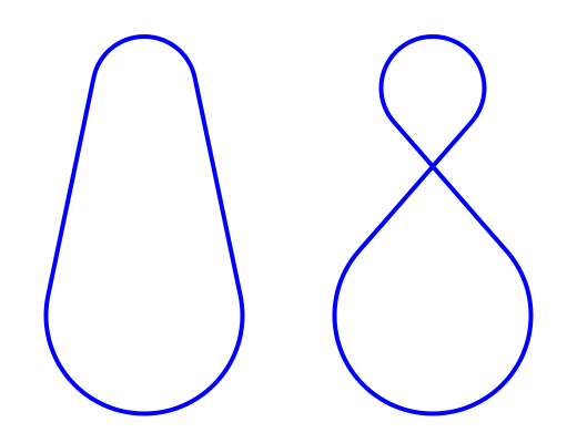

@K1TesseraEna: eventually computing tangents isn't that hard. I have cornered the tangents from a point, tangents between circles come next. These lines are indeed useful to create nice and clean figures:
Question about the interface:
1) There are many tangents: from a point you have two (unless the point is in the circle), between two circles there are four in the general case (two if they intersect, none if one is included in the other). So, would it be useful to distinguish the tangents by producing them on distinct paths, those unneeded being more easily ignored/erased than if they were strokes in the same path?
2) Unlike the other shapes, that use paths completely created for that purpose, tangents apply to pre-existing paths so circles and points will usually be in different paths. So how is the second path specified? In a usual dialog or more implicitly (linked or visible path)?

OK, new version with the tangents at the usual place:
Both tangent entries assume that the first stroke on the target path can be see as a circle: 2 point is a circle by center and radius, 3 points or more is a circumcircle (this case also covers circles produced by the circle entries...).
Then either:
- there is another path "linked": each stroke it contains is used to determine tangents. For the point to circle, every point in the stroke(s) is used to compute a pair of tangents, for the circle to circle, each stroke is interpreted as a circle depending on number of points, as above.
- there is no linked path: the script uses other strokes in the same path (but nothing in Gimp guarantees that the order of strokes is preserved, so getting the circle in 1st position may be difficult.
The output is two (point to circle) or four (circle to circle) paths, where the strokes are grouped by type/side. inner/outer and left/right.
Enjoy
