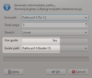

I made a third path with the curve but I don't know how to tie that in with the to and from.
If your dialog doesn't look like this, then you need to get the latest version.
 Post subject: Re: path-inbetweener
PostPosted: Tue Nov 04, 2014 9:23 am  (#109)
Strange, I downloaded that this morning and got rid of 0.0 and gave it permissions. My dialogue is still the same as it was before.
PostPosted: Tue Nov 04, 2014 9:31 am  (#110)
Well, when you start the dialog it shows you what file it is actually executing.... (see the top of my dialog screenshot). Yours will also have the version in the file name (if you didn't remove it). You may have had duplicate versions of the old one (and Gimp registers only the first one it finds).

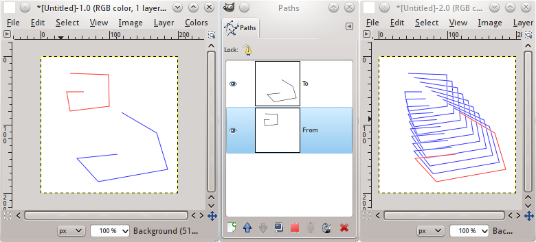

I've used your script to create flat design drop shadows*. I wrote down some notes back then but had forgotten to ask you. So here they are
The script doesn't blend paths using the nearest anchor points
but according to the paths start and end points?
That's what I'm getting with two 3angles: before and after rotating big 3angle 90 degrees clockwise.
Had to cheat to blend these two paths ;)
*Now look at the comment #30 in that thread and you being all skeptical about inbetweener script capabilities, lol

K1TesseraEna wrote:
[font=Tahoma]I've used your script to create flat design drop shadows*. I wrote down some notes back then but had forgotten to ask you. So here they are
Yes, it's the order of the points that counts(*). Using the closest point when you twist the path over itself would yield unpredictable results. It would also break the assumption that you get the same results if you take the end paths and one of the intermediate paths and run the script on both sides.
For polygons, it's easy to force the first/last points. Just delete any segment between two points, and reconnect again. The new start and end points are the two points you reconnected. Of course you don't now in which direction the polygon runs, but I have a script to reverse strokes. For curve paths a similar technique is possible but requires a bit more care to preserve the tangents.
