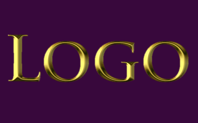

I did as you suggested and the cropping has now disappeared and the plug-in functions to my satisfaction, if perhaps not to yours. I have not been able to work out how to get it to display here and when I provided a link to imagebam was told that the post looked too spammy for a new user.
Ken

I think that your clipping problem occurs because you are running BRL from the Alpha To Logo menu on a layer containing text information. Problems can occur when there is an incorrect selection in place (entire layer is selected) or the layer contains additional text information. To avoid this issue, I suppose I could just automatically discard the text information from within the script, when applicable.
Before running from Alpha to Logo, you might want to ensure the layer is sized to the image and the entire layer is not selected. If there is no selection in place, the script will automatically perform an "Alpha to Selection" on the layer, otherwise, you can manually select the section of the layer in which you would like to apply the effect.
As far as why the 64bit version of the plug-in is not working for you, I'm not sure. At least the 32bit version works for you in GIMP portable, so you're good to go. :bigthup
You need 5 post to be able to use external links here. However, you can attach images using the board's image attachment feature, located just below the "Submit" button on the post entry screen (Full Editor).

Posts: 7
Hi GnuTux,
If it is simply a matter of following the steps you gave then the plug-in is completely functional as far as I am concerned and I am delighted to have it. Many thanks,
Ken

Looks great, Ken, Glad you got it working. :2thup
 Post subject: Re: Bevel Reflect Logo V1.6
PostPosted: Tue Feb 24, 2015 10:25 am  (#1013)
Very beautuful Ken, I love the gold with the purple, really makes it shine.
Did you try shrinking the selection a 2 or 3 pixels before running the script, that helps to get a smoother edge.
