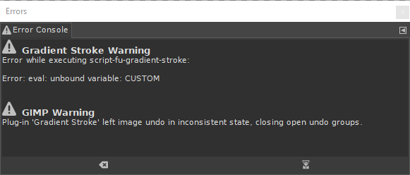

I downloaded and installed the version found in the first post #1 V1.4. But on my Gimp 2.10.21 Win10 64 I get error messages. :roll:

I get the same error message as Krikor (post #125 above), on Windows 10 64 bit with Gimp 2.10.20
If you open the scm file, just replace "CUSTOM" with the number "3". Problem solved.
@Mahvin,
After replacing CUSTOM with number 3, it still gives an error, this time:
Thank you for your help.

LINEAR is 0 (Zero)

There is. It's in the procedure browser under "Help". You just have to look up the procedure and check. For instance, "gimp-edit-blend" for CUSTOM error, and "plug-in-bump-map" for LINEAR error.

I tried using this script and I received an error. I am using windows 10 gimp 2.10.22.

no problems in the script just go to gimp-edit-blend and change CUSTOM to BLEND-CUSTOM or 3 as per below
(gimp-edit-blend        ; Blend (Gradient)
                        stroke-layer ; Drawable - (The affected drawable)
                        BLEND-CUSTOM ; Int32 - Blend Type (FG-BG-RGB-MODE (0))
                        paint-mode   ; Int32 - Paint Mode (NORMAL-MODE (0))
                        blend-shape  ; Int32 - Gradient Type (LINEAR (0))
                        100          ; Float - Opacity (0 - 100)
                        blend-offset ; Float - Offset ( >= 0)
                        blend-repeat ; Int32 - Repeat (NONE (0))
                        rev-gradient ; Int32 - Reverse (TRUE or FALSE)
                        TRUE         ; Int32 - Supersample (TRUE or FALSE)
                        3            ; Int32 - Supersampling Recursion  Dept (1 - 9)
                        0.25         ; Float - Supersampling threshold (0 <= 4)
                        TRUE         ; Int32 - Dither (TRUE or FALSE)
                        xblend-start ; Int32 - X Blend Starting Point
                        yblend-start ; Int32 - Y Blend Starting Point
                        xblend-end   ; Int32 - X Blend Ending Point
                        yblend-end   ; Int32 - Y Blend Ending Point
             ) ; End Blend

I tried changing custom to blend-custom and then 3 when blend-custom didn't work and I still get the error.

Thanks to "everyone" who tested, found bugs and updated code. :mrgreen:
I didn't have the errors others had with GIMP 2.10.20-1 and wasn't sure why. I thought the only thing that might be different was that I was still using Scrolling Interface Mod V1.1, and it turned out that was why it worked for me without error. I actually figured it would be the other-way round and Scrolling Interface would only "cause" errors, but with 2.10, both could occur.
So, I've updated the script to Gradient Stroke V1.5, which seems to work properly with or without Scrolling Interface Mod V1.1.
Thanks to mahvin & Graechan for coding. :bigthup
; V 1.5
; Update CUSTOM To BLEND-CUSTOM
; Update LINEAR To TRUE
