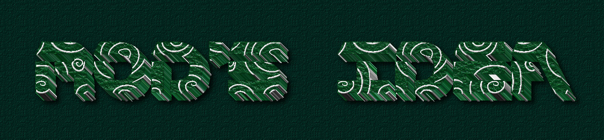

2-ton wrote:
Nice idea, this opens up a whole new world of text looks!
:tyspin 2-ton. You can do a lot with alpha patterns. :hi5

2-ton wrote:
Indeed! And I am wondering if you can take any pattern and give it an alpha channel, and how you would do it...or does it actually need some transparent spaces in the pattern to work.
Yes you would need transparent areas in the patterns.

PostPosted: Mon Sep 12, 2016 11:19 am  (#1286)
Posts: 14162
Thank you Rod. Your idea is great to give a nice touch on texts. :bigthup :tyspin :coolthup
Very nice Issabella!
