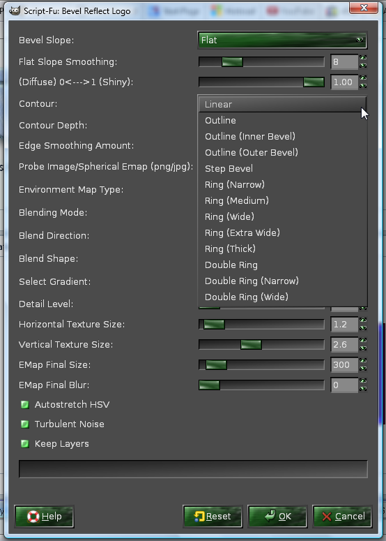

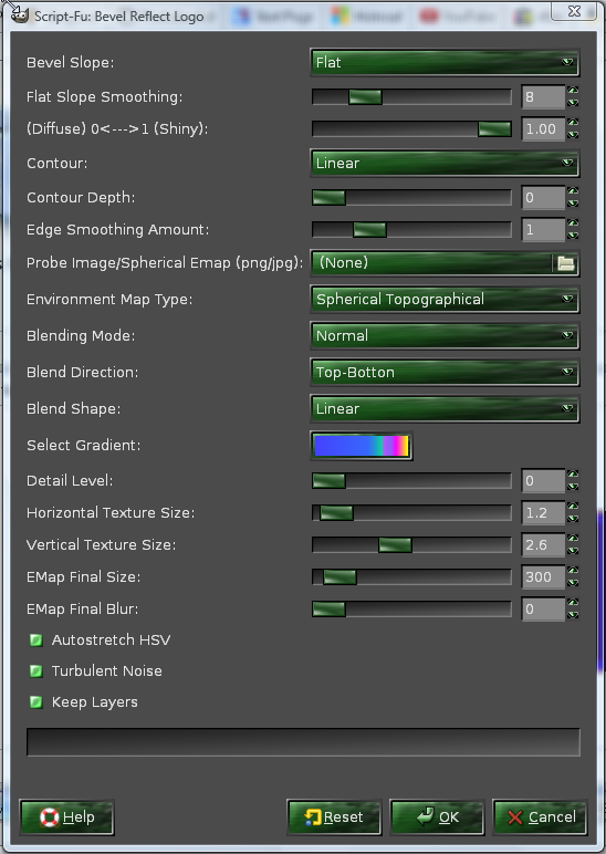

Greachan, it only appears in the Alpha to Logo Section of the script. You can run the script from the File/Create menu, hit Ctrl-z, which will undo everything except the text layer, then run from the Aplha to Logo menu. That allows you to quickly create the text, then you can run with all the options available in the Alpha to Logo menu.
All of my Logo Scripts work this way.

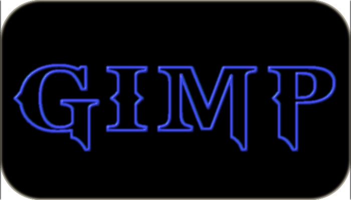

Those are some pretty cool effects, Molly. You just gotta remember to merge down your Text layer onto a transparent layer (or discard text info) before running. ML Bevel Reflect will create those lines on either side when running a "floating" Text Layer.
Oh, and where's the contour curves? :mrgreen:

Thanks, I will remember to do that next time about the lines, ... and I don't know how to run the curves, before or after the script, alpha or value. I tried one and it sucked so changed it back.
