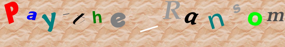

Thank you RobA and Saulgoode I now have all the necessary pieces of code to put it together for K1TesseraEna :yes
K1TesseraEna you will have your Ransom soon :rofl

GnuTux I have a few problems with it though,spaces seem to mess it up

GnuTux I finally have my spaces
I don't think Muti-line text is within my grasp yet (but I'll start pondering now), biggest problem is that each letter is on it's own layer
the best I could do is set assign a SF-STRING for each line

I have my lines :yes

The script has not even reached the Beta stage yet as I had hurdles to overcome and tests to do on the basic code for it
Thanks to RobA Saulgoode and GnuTux who have assisted
Now I have to add some finishing touches↓as in the 'm' and the 'p'
