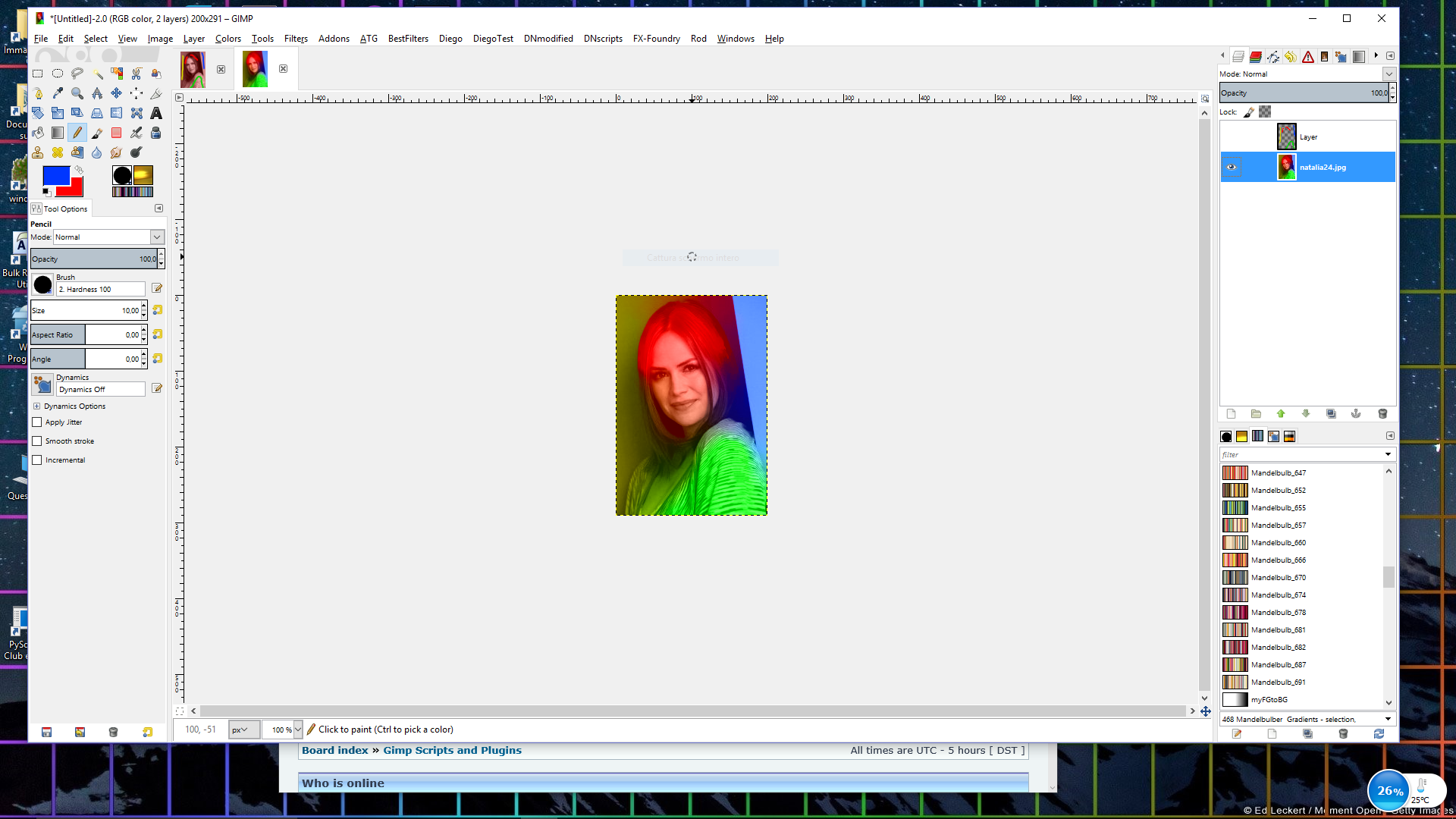

I don't have the xcf output because I didn't save it. Just by looking at the image, I can tell that something is wrong. I just can't figure out what it is.

..and remember that when script has finished you have to set visible off on the transparent layer
Now that you said that, it makes sense.
Here is the XCF file anyway.
I'd rather not have it colorize the entire image and when I check uncheck that option, but check the others just to play around with it, I find it useless and the plugin still colorizes the entire image no matter how many colors are used on the transparent layer. Something else is wrong with the plug in.

I used your image and put here:
- Cattura1 is the snapshot "before"
- Cattura2 is the snapshot "after" the run
(I used my colours...)
Now, it's a bit late for me. You may try again if you will, I will see your posts tomorrow.

I have tested it out. Here are my examples:
You have to remember to have a selection before running the script.

Rod, it seems the filter works only with small picture.
Not a matter of performances, the result is totally wrong with larger ones.
I took the same input image with which I made my first test, repeated at the original size and it still works fine. Then almost doubled the size and got wrong result (see attachments).
Do you know whether you (or someone else) can check the source to identify where the problems lies?
Thanks
edit: it seems I'm unable to attach the 2 .xcf, but you may perform yourself the test:
- first with the original size (OK)
- then doubling the size (absolutely bad for me)
Thanks
I can confirm this. I even blurred the original at its regular size and it worked. So displacing or smoothing pixels doesn't seem to effect. Only when you scale the image larger.
I even scaled the image 2x SMALLER and it worked. Weird.
