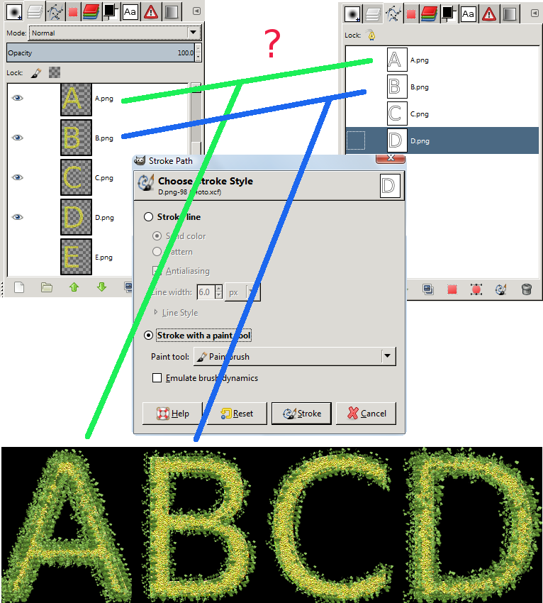

PostPosted: Fri May 13, 2016 7:59 am  (#35)
My request:
I created a layer: A, B, C .....
I created a path: A, B, C ...
Is it possible to script-fu (for all layers):
stroke path A on the layer A
stroke path B on the layer B
and so on (when the layer name = path name)?

MareroQ wrote:
My request:
Here it is it'll available under
<Image>/Python-Fu/Stroke Layers With Samely Named Paths...
stroke_layers_with_samely_named_paths.zip [722 Bytes]
Downloaded 147 times
Just unzip it to get the .py file and toss that into your gimp's plug-ins folder (and restart GIMP)
What the script does is it loops through all your layers and loops through all your paths if it finds a match it's stroke that layer with matching path using the active brush and foreground color.
TinT

PegLeg44 wrote:
trandoductin wrote:
I was bored... and wondered if you already have something like this or maybe this will be of any use to you.
I call it Create New Gradient from Black Drawing
It scans the active layer from left to right, then from top to bottom and looks for black pixels.
the first pixel it finds from the top down and save the y coordinate
Then it creates a new gradient with (layer width-1) number of segments so that it has layer's width's number of colors.
The it loops through and sets the colors to a gray scale of the y coordinate..
for example if it finds a black pixel at y coordinate 0, it'll make that color on the gradient to be (0,0,0) (pure black)
if it doesn't find a black pixel at y coordinate for a certain x, it'll make that color on the gradient to be (255,255,255) (pure white).
so basically you can have an active layer that is (a width of your choice) x (a height of 255) and you can create gradients to use as height map.
Here i'll just show you an example.
here's a simple drawing i used to run the script on.
and then i run the script and i get a gradient that is like this
Is this script useful to you at all? Or do you already have something that helps with this?
Anyways here's the script. Let me know what's up.
It'll be available under <Image>/Tools/Create New Gradient From Black Drawing...
create_new_gradient_from_black_drawing.zip
I was just playing around and was able to create gradient that is very similar to your 01RoundFull Gradient. I even tried to compare them by blending one layer with your 01RoundFull Gradient and another layer with my gradient from image below and set top layer to difference and the image is all black (don't know if they're pureblack but definitely close)
here's the screen shot of how i created the similar to your 01RoundFull Gradient.
I tried this script yesterday and it works pretty good on a canvas that is 256 pixels in height.
Yeah i wrote it thinking that it should be 256 in height to define gray scale values. so yeah 256, if your height is larger it just ignores pixels lower than 255 on the image (with a higher y-coordinate) and consider them 255.

trandoductin wrote:
try this and let me know if it works like you wanted. I followed every single step.
path_to_selection_for_PegLeg44.scm
It'll be available under Script-Fu/path-to-selection-for-PegLeg44
it'll select the active/selected path (just in case you have multiple paths defined/drawn)
trandoductin
I've gotten some good use out of this script already and have come up with one way that it could be just a tiny bit better. If you could add at the end of the script lets say step 10 run the [Layer] [Transparency] [Alpha to Selection] and then step 11 [Layer] [Crop to Selection]. You see this would make the file size of my images smaller.
And I would like it if you could call the script (Path to Darken Layer). This name would more suit the function.
I have noticed another thing while doing my work. I often times skip using the path. I just quickly make a selection using the fuzzy selection tool and then the layer etc. If you could alter the script to skip step 1 (starting with path to make a selection) but instead if I could have another script that just starts with a selection and then does the rest of the steps from 2 to 11 that would be useful to me. I was thinking that this could be called maybe (Selection to Darken Layer).
I just want to say that I appreciate all the script work that you do.
Thanks, Alan
