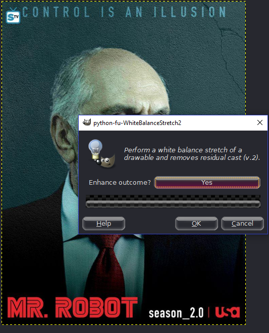

Joseph,
this is the dialogue: only a single parameter, to set a post-processing enhancement step or not
