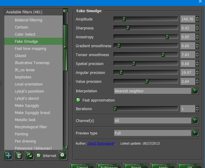

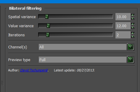

I used lylejk stencil followed by anisotrophic smoothing (saved as a preset I call fake smudge) and the I dupped, run bilateral smoothing on top and merged down to create a convolution layer and duplicate to taste. :)

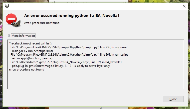

Hi Gimp users
I get the next error when i am running the Novella Filter.
So i need your help
Thanks.

doronf2 wrote:
Hi Gimp users
So i need your help
Thanks.
Are you using G'MIC 2.0?

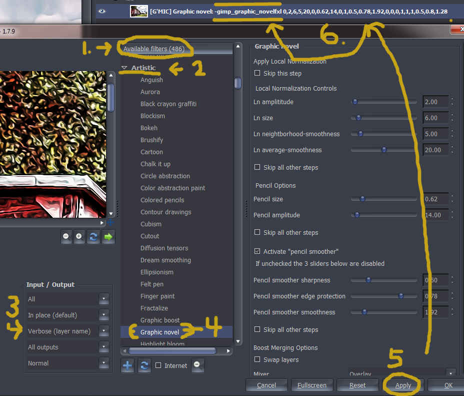

Sallyanne, there was an error in preset 5, it is fixed in the new version (on page 1 of this topic ver 1a ). I don't know about a reset to default button Do you know of a python script with that feature? (maybe I could add one).
DoronF2 - you must select your G'mic version (1.7.9 or 2.0.0) before running the filter.
I put a reminder on the menu in version 1.a
Hardy111 -
I found no mistake on or around line 175 and the script ALWAYS calls Graphic Novel no matter what options. Please check to see if you have Graphic Novel installed in your Gmic 1.7.9 and if so, let me know what the command string (#6) says! Thank you Hardy!
Photomaster - thank you for the error report. #5 had the original lines from
before 1.7.9 functionality was added. They were not indented under the IF so they
would cause a problem with either Gmic version. It was late at night and the last
thing that I changed!
