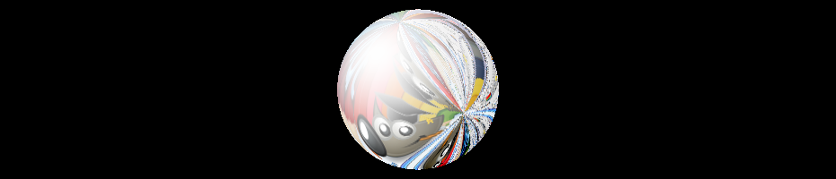

yay! i downloaded and installed the extra filters...sweet! =)
This plug-in is really far-out!
polar inversion
sphere with reflection..
 Post subject: Re: Mathmap
