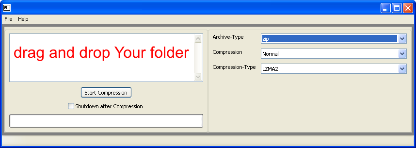

Thanks Rod!
http://sourceforge.net/projects/sevenzipbc/files/Binary/7zip%20Batch%20Compression%200.3.2.7z/download
A very good tool - drag and drop.
Convert all files (~ 1000) *. scm in 2 minutes.
One note: the source file name must be without a point.

MareroQ wrote:
Thanks Rod!
I know right?
No more right click send to zip...right click send to zip...this is so much easier on the mouse. :lol
Funny thing is i could only find a very few that do this batch zip on files. You think there would be many more.
Most of the ones i found will zip an entire folder into 1 zip but that's it.This was a Godsend i tell you.
