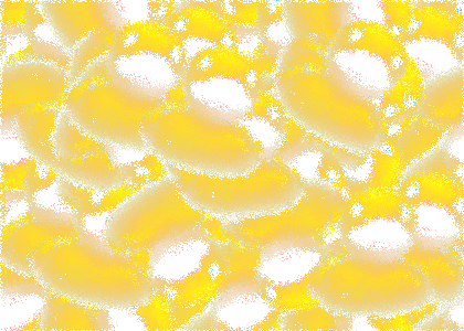

OK; The original image as embedded alpha and the result shown is after I ran Cybia's Alphaworks filter and got placed back into GIMP (identical as before running the filter). The second version how it should be. I saved it while still in XNView. I have an idea why this is happening. Maybe if you can figure out how to paste it back in another layer besides the calling layer, you can get the proper result. :)

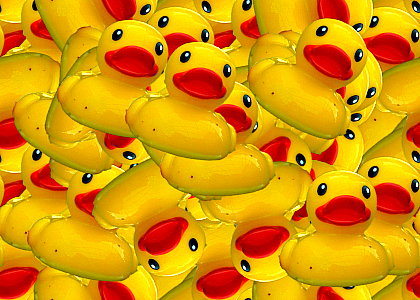

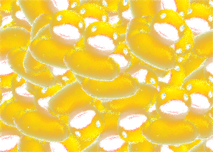

Ah; just tried it with a layer that already has transparancy components and the result that comes back is different then if I saved it externally further backing what I think is the problem. :)
What should be the result:
What comes back inside GIMP:
