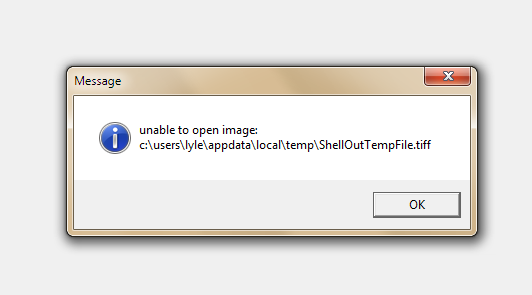

Thanks for pointing that out MareroQ; I, indeed, had version .4 and needed version .5 but now I get this error with Delaboratory (and even after opening a tif file like Rod outlined). :)

Just to add, I did open the resulting tif file in Irfanview and, despite the .tiff extention, Irfanview said that it is still a PNG file and additionally asked if I want to save it as a PNG. So the problem is somehow still with how shellout exports file type. :)

ShellOut version must be 0.7 - otherwise it does not work

I've updated the version at the GPR http://registry.gimp.org/node/24977 to be the latest version to fix the "saving non-png files as png files with the wrong extension" bug.
Sorry for the confusion this has caused.
