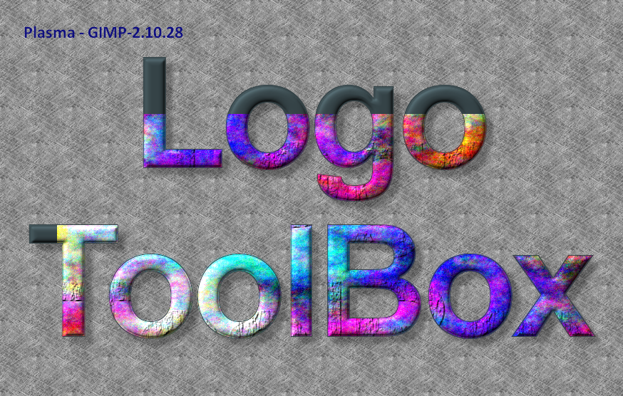

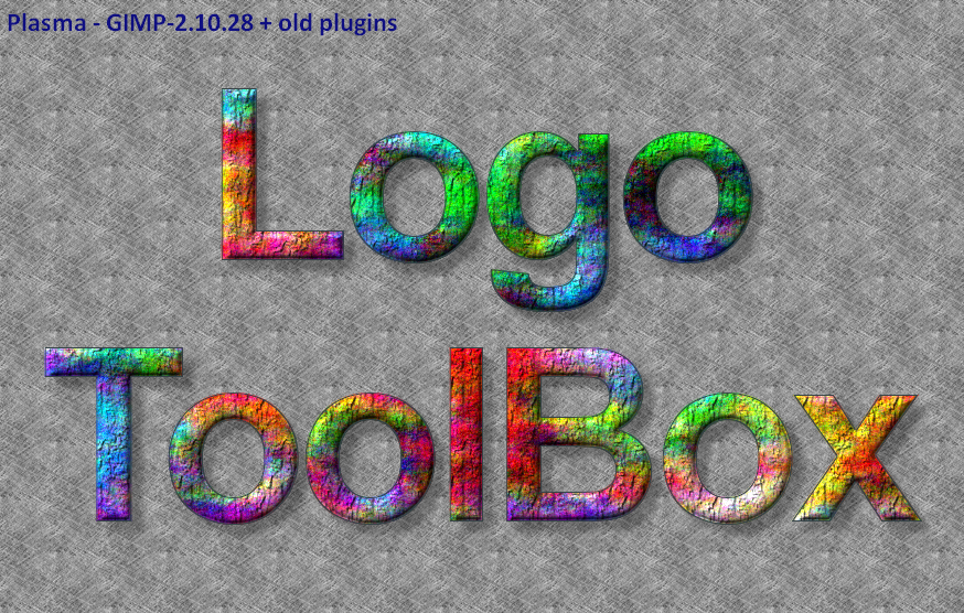

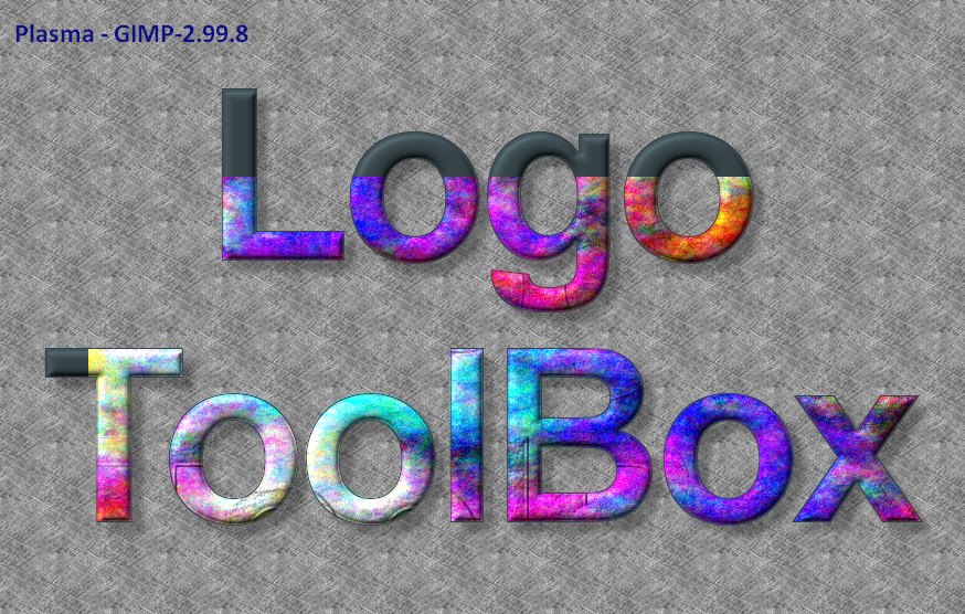

I am glad that the "new forces" have made further attempts to repair.
When one plug maintainer is missing, however, it does get messy.
In 2018 TT released plug 3.0 (but not here, with one fix because it was enough).
It wasn't until 2020 that I introduced version 2.4. (over 60 corrections mainly related to old procedures).
The Vitforlinux version is a patch to version 3.0 (but the old procedures remain - because they still work).
In order for it to work in GIMP-2.99, in addition to the fixes from 2.4, you need to add 40 more - and the result is not very good for most settings.
So a question for Vitforlinux:
Will you undertake the slimming of Logo-Toolbox (elimination of malfunctioning options) ???

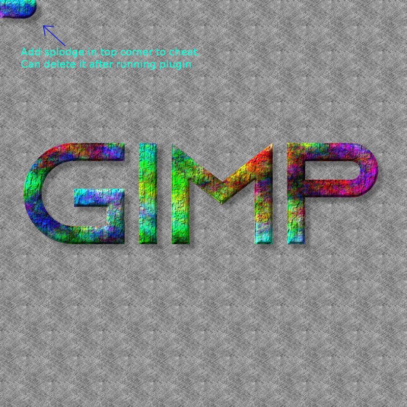

It looks like a selection messes up the offsets so the plasma is in the wrong place. The bug should be reported, I don't know if it has been.
For people (like me) that don't want to install the old plugins a quick and dirty cheat is to make the item(s) to logo on a transparent layer the same size as the image, add a blob in the top left hand corner, if any selection do Select None, run Filter -> Alpha to Logo -> Logo Toolbox, and then delete the blob. That way there are no offsets for it to muck up :hehe
I know that's scrappy but better than deleting the plasma and other options. Please don't delete them.
