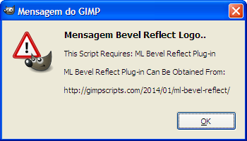

I installed Bevel Reflect Logo V1.5 script. Before I installed the plugin MLBevelReflect.exe. I restarted GIMP. I requested the Bevel script Reflect Logo. A window was open. I clicked OK. I got the error message. With the previous version, everything was working fine.
I found the solution. The plugin MLBevelReflect.exe was in a subfolder inside the plugin's folder.

Carlos,
You need ML Bevel Reflect V2.0 to be able to run V1.5 of the Logo script. You can grab the new version here.
Overwrite the old version in your plug-ins folder, restart GIMP and you should be good to go.

Thanks, GnuTux.
