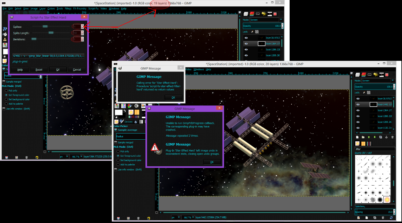

PostPosted: Thu Jan 29, 2015 10:00 am  (#48)
Joined: Nov 15, 2014
Posts: 161
I downloaded the updated script, set the spikes to 6, the length to 100, iterations to1 and it's been going for about 5 minutes now and it's up to 84 layers. Is that supposed to happen?
 Post subject: Re: Star Effect Filter Scripts Rel3 (Added setting for number of spike
PostPosted: Thu Jan 29, 2015 10:43 am  (#49)
Joined: Apr 23, 2010
Posts: 1553
No, it is not. There are a few different ways to remedy the problem.
@graechan, the problem is caused by the SF-ADJUSTMENT returning a non-integral number, even if you have the precision set to "0" (see the second part of this posting for a description).
You can remedy this by one of the following methods:
  • Change the SF-ADJUSTMENT from a slider to a spinbox (i.e., change last argument from "0" to "1"). (You might also change the step value to "1"; I can think of no reason to disallow an odd number of spikes.)
  • Add "(set! spikes (truncate spikes))" to the start of your procedure.
  • Change the test in your spike loop from "(unless (zero? cnt)" to "(when (>= cnt 0)".
note: whatever you do may have to be done twice in the script, once for the G'mic version and once for the plug-in version.

PostPosted: Thu Jan 29, 2015 11:11 am  (#50)
Posts: 161
I had to force close gimp to get stop. I gave it another test leaving it set to default and it worked fine. Then I adjusted # of spikes up 1 and it went buggy again.
PostPosted: Thu Jan 29, 2015 4:52 pm  (#51)
Charlie unable to replicate your problem using the same settings

saulgoode wrote:
Saulgoode I can change to a spin box and the reason I have disallowed an odd number of spikes is that Gmic's Linear blur blurs in both directions e.g when set to 90 degrees it also blurs at 180 degrees so if was set to 5 spikes it would actually return 10 spikes (I'll try something else from Gmic)
PostPosted: Thu Jan 29, 2015 7:10 pm  (#53)
Joined: Dec 27, 2014
Posts: 508
Graechan: I get the same result as Charlie .. if any adjustment is made to the "Spikes" slider the script goes awol.
The problem is as saulgoode indicated ..ie. the slider is defined with precision=0 (meaning that only the integer part of the value is displayed in the dialog box) but the value passed to the script is a full float value (accurate to about 10 decimal places) representing the actual position of the slider as set by the user. That float value will never decrement to precisely zero ..it goes past zero and just keeps on going negative! (The "(zero? cnt)" condition never retruns true.)
Since the "spikes" value is also used to determine the spike-angle you also get some very strange angles ..again accurate to about 10 decimal places.
The simplest solution is to insert the line:
at the top of the procedure ..it works fine then.
For good measure you could also change the "(unless (zero? cnt) .." to "(while (> cnt 0) ..)" ..the same as the "iterations" loop later in the script.
