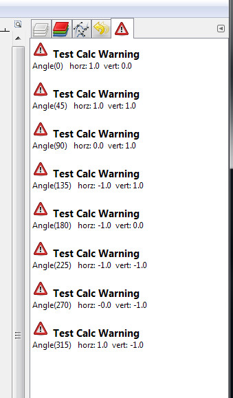

I did my Test Calc. I hope everything is all right now. ;)
 Post subject: Re: Need Help Testing A Simple Script
PostPosted: Tue Mar 17, 2015 12:09 pm  (#56)
Looks good, Issabella. You're getting the correct results. :bigthup
You can go back to the official release of 3D Extrusion now and all should be well.
