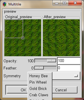

Multitile (very rarely open GIMP 1.2.4 because of this one, but have done so in the past)

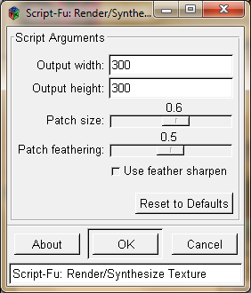

Synthesize Texture (of course the reason this thread got started in the first place. Someone recently posted the Make Seamless Texture plugin for GIMP 2.x, so happy I am for that, but the Scriptfu still doesn't work and Sharpfeather plugin, of course, is only compiled for GIMP 1.2.4). :)

Just tried to compile multitile, and no dice. It seems to have too many errors on the compile, and after extensive searching and reading, I can't find any information to help me figure out what it needs.
In file included from Multitile-1.2-beta1.c:48:
mt-mode-tiles-xy.h:39: warning: conflicting types for ‘honeybee_tiles_xy’
mt-mode-tiles-xy.h:39: error: static declaration of ‘honeybee_tiles_xy’ follows non-static declaration
mt-mode-tiles-xy.h:14: note: previous implicit declaration of ‘honeybee_tiles_xy’ was here
In file included from Multitile-1.2-beta1.c:51:
mt-geometry.h: In function ‘symmetry_menu_callback’:
mt-geometry.h:30: error: ‘stypes’ undeclared (first use in this function)
mt-geometry.h:30: error: (Each undeclared identifier is reported only once
mt-geometry.h:30: error: for each function it appears in.)
mt-geometry.h: In function ‘create_selection’:
mt-geometry.h:90: error: ‘stypes’ undeclared (first use in this function)
Multitile-1.2-beta1.c: At top level:
Multitile-1.2-beta1.c:59: warning: initialization from incompatible pointer type

The Synthsize Texture Script-fu has an option for Feather Sharpen and that doesn't work. When I uncheck that option, it was still buggy (the version that supposedly works for GIMP 2.x that is).
Feather sharpen is now compiled (as everything in textureops) but NOT for 2.6 ONLY for 2.7.2 and ONLY for 64 bit download/file.php?id=1861
well a 32 bit version should follow soon anyway that is what ready now
...and sure without that the script will give errors at least if that option is checked

I have Multitile down to two errors, and for the life of me, I can't figure out these two errors:
Multitile.c:288: warning: initialization from incompatible pointer type
Multitile.c: In function ‘main_dialog’:
Multitile.c:1621: error: too few arguments to function ‘gimp_color_balance’
That's it.
It originally had gimp_color_cube(), which I could find no reference to in the GIMP Library Reference Manual. I attempted to use gimp_color_balance, but I know for certain I am not getting the transfer and boolean correct for the 3 colors, and besides I don't even know if this is the right approach.
The incompatible pointer type, I just don't get it. I've cross-referenced the pointer with a number of recent compiles, and it "looks" legit, so again I am lost. If it's an indentation issue, I did manage to indent it correctly. Not sure. I'm like a mad scientist putting together bodies with mis-matched parts. :gaah
