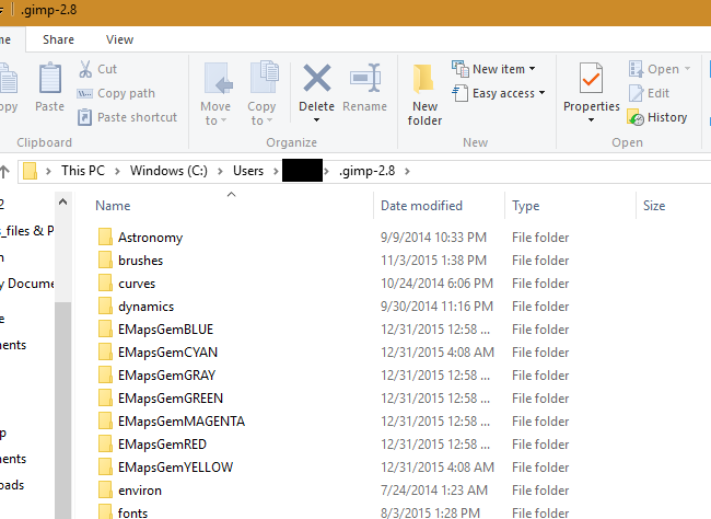

The emaps need to go to your users/.gimp2.8 main directory (each as it's own subdirectory). :)

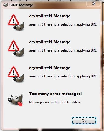

I am also having difficulty. I downloaded the last script as I could not get the first to work ( DIEGO_QUANTIZE_CrystallizeN.7z ). The script runs, but I keep getting these errors, and the output is horrible.
I am using Windows 7.

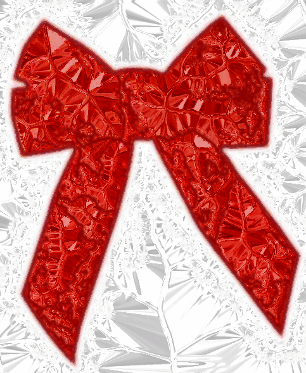

I took a much simpler image to try this time. I still got all those messages of errors but the filter ran all the way through. Turning off some of the layers gave me a decent result. Why all the errors?

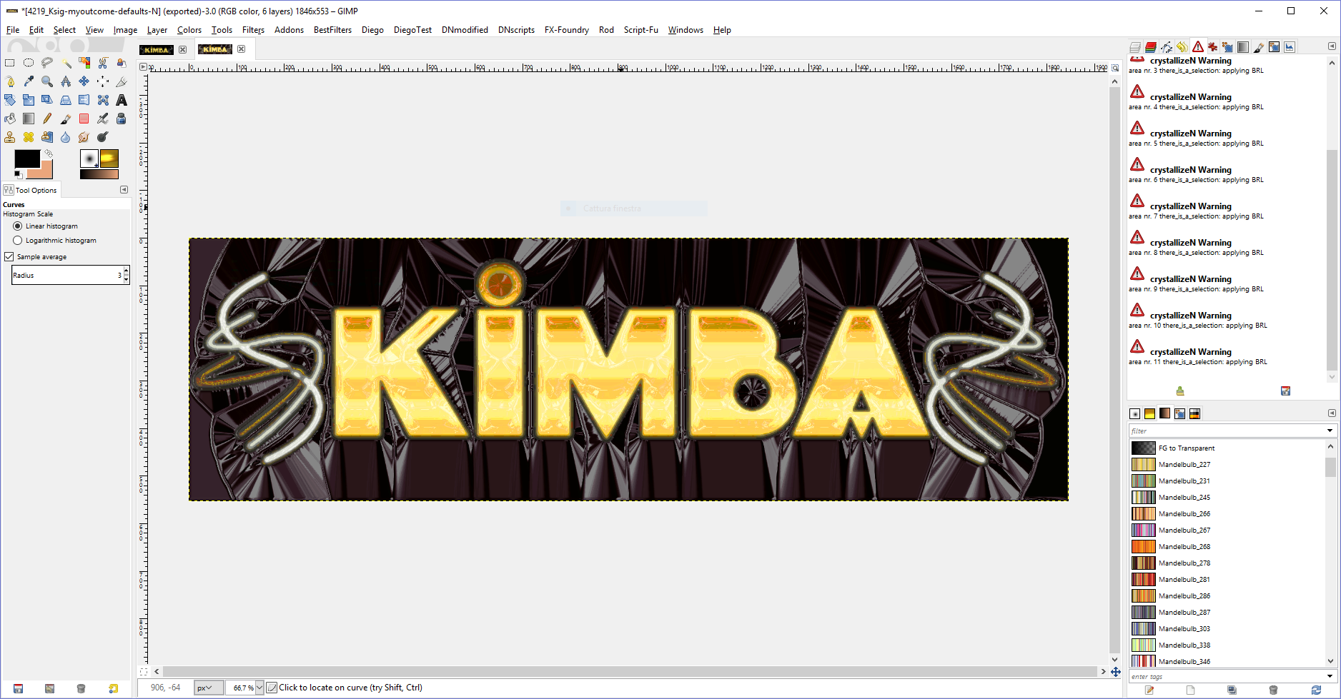

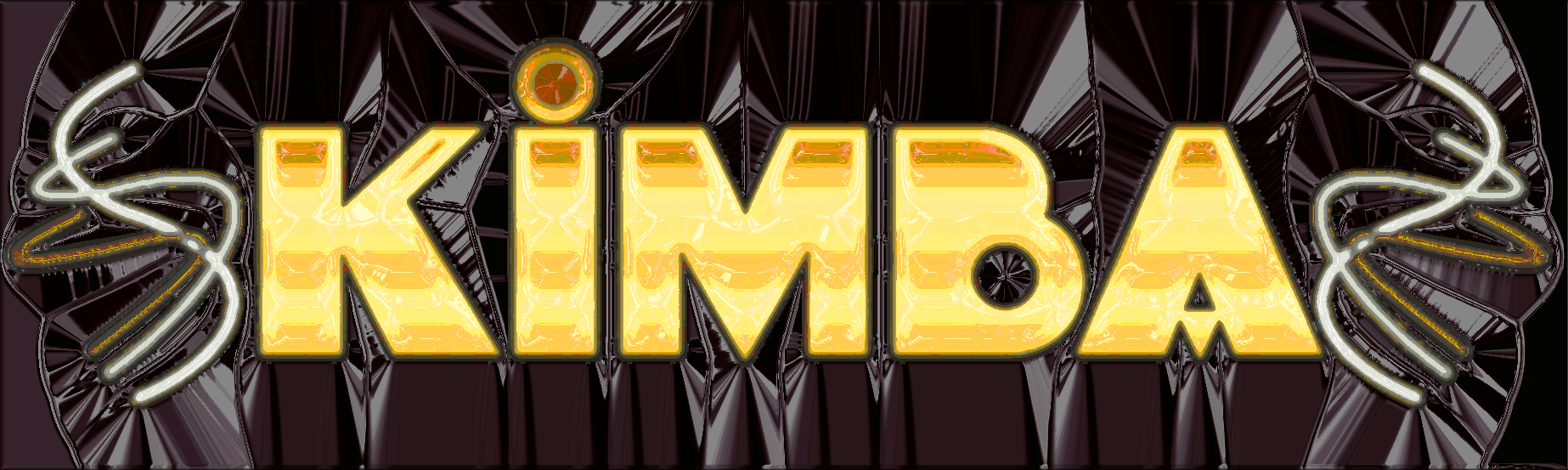

@Kimba
I took your sig image, here attached:
- the outcome running CrystallizeN with default parameters
- the screenshot at the end showing also the messages (did you get all of them up to area nr 11?)
