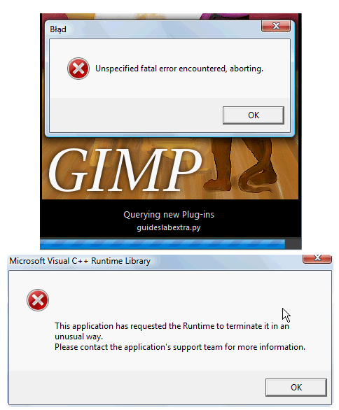

PostPosted: Sat Oct 29, 2016 3:43 pm  (#78)
Hi Peter.
Guideslabextra.py is very interesting - but tough code (need more time).
Unfortunately, as most plugins Arakne for Gimp 2.9.5 does not work.

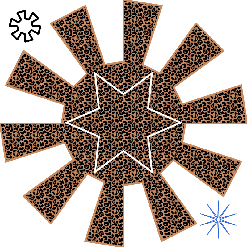

Rel 1.0:
- correction shapes "Recycle" (bad axis :oops: ),
- add shapes "Gear", "Star", Polygon" created by Jonathan Stipe 2004-2006 (necessary script-fu Shape-path.scm).
This is not the end - but a longer break. :roll:

MareroQ I have thoroughly tested Rel1.0 and found it a very stable release :bigthup
