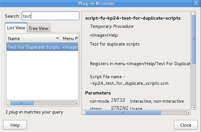

Here's v1.8, which I think should work for both 2.6.7 and 2.8.0 (at least I've tried it on a Windows XP machine with both 2.6 and 2.8). It now identifies itself as v1.8 in the menu entry just to make it easy to see which version you've got.
Kevin
kp24_test_for_duplicate_scripts.scm [27.37 KiB]
Downloaded 283 times
