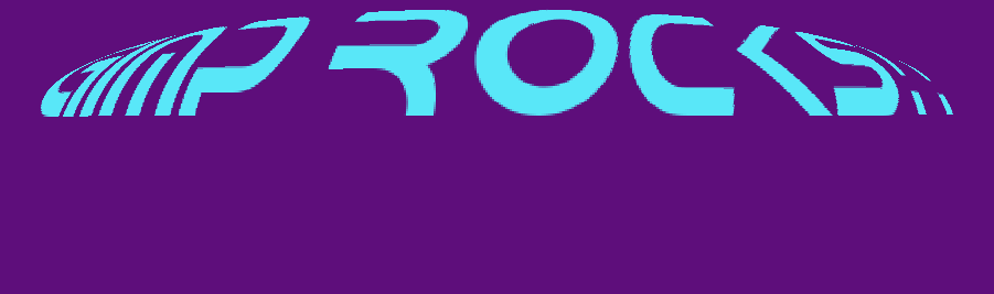

This is great fun! Thanks again, Graechan! (and you're welcome!)
The only thing I'm having trouble with is creating a frame... I think I have the Beautify plugin, but I'mm getting an error message....
"Animation WorkShop Warning
Error while executing script-fu-animation-workshop:
Error: ( : 1) eval: unbound variable: plug-in-simple-border"
(Never stop learning!)
 Post subject: Re: Animation WorkShop.scm Rel4 [additional effect & border opt.]
PostPosted: Tue Jan 17, 2017 10:13 pm  (#63)
How can I fix the animation to have the same delay at the end as the beginning. I have noticed that when it swirls or swings, it reverses (ping pong) back faster than at the start. Not meaning the whole thing, just the frames at the reverse don't seem to have the same delay as the frame at the starting point. I am not sure I am explaining this right.
'Simple Border' is one of the Beautify group of Plugins do you have it installed?
PostPosted: Tue Jan 17, 2017 11:12 pm  (#65)
I can only try to explain as best as I can, all frame delays are set by default the same as defined in the menu, to alter the delay of a particular frame, select the frame and right click selecting at the top 'Edit Layer Attributes...' and alter the timer of that frameor
