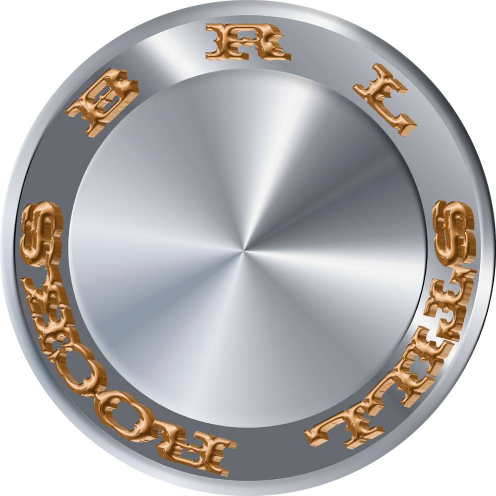

 Post subject: Re: Bevel Reflect Logo V1.6 (FG-BG Gradient Bug Fixed)
PostPosted: Thu Oct 09, 2014 2:38 pm  (#729)
Posts: 14168

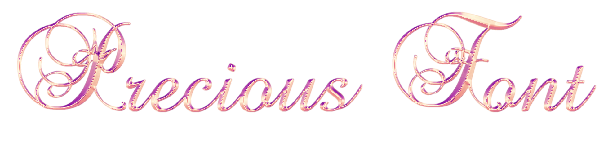

Nice outcomes, Oregonian, Sallyanne and SysTemX. I like them. :hi5
I think the font used by Sallyanne is "precious"
Precious is beautiful and pretty similar but I instead used
@ Oregonian it is here
http://fonts.webtoolhub.com/?prefix=baroque+script
WOT says the page is safe. I can't remember where I got it from, doesn't look to be at dafont.

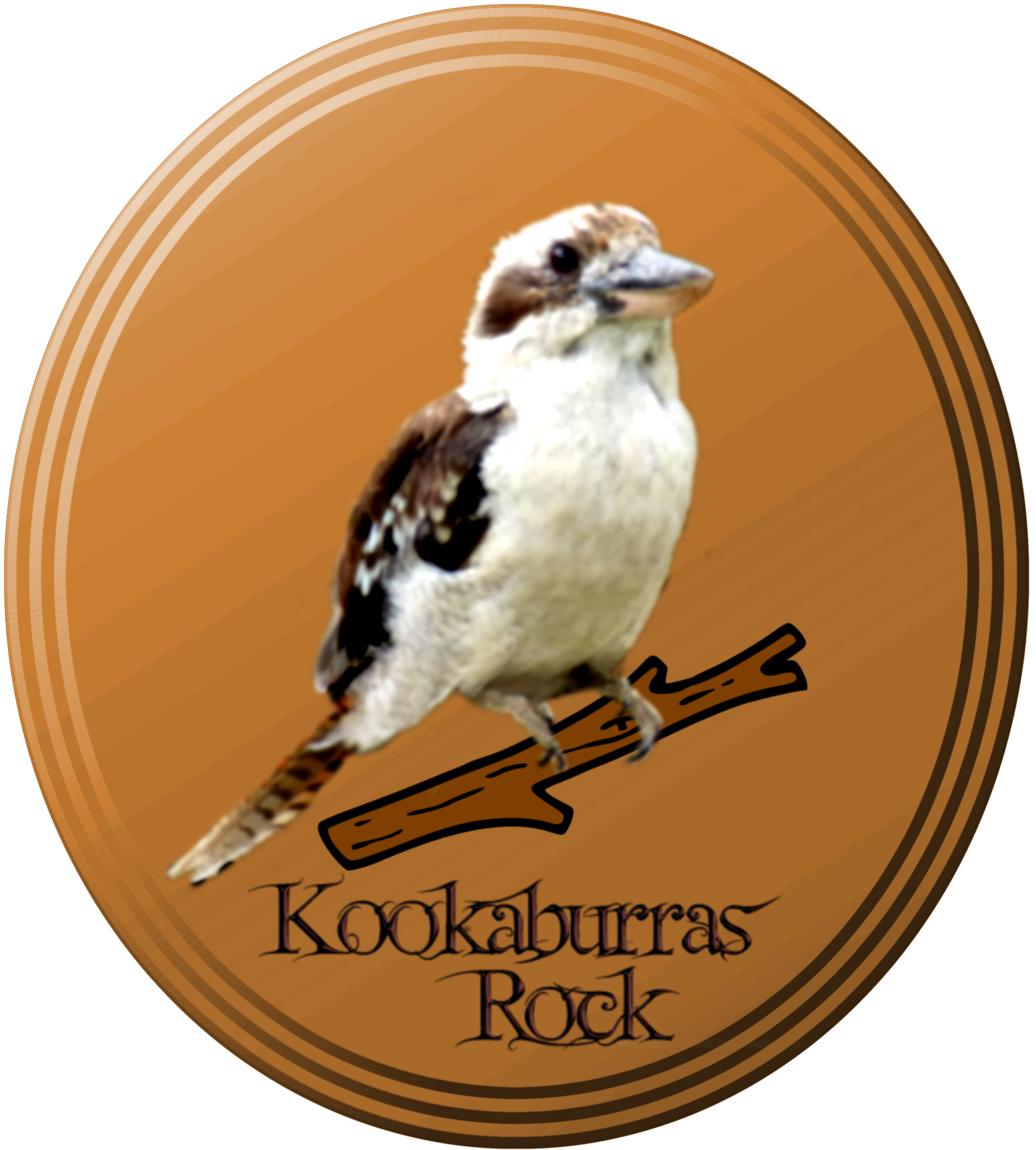

Edit ... what a day learning layer masks, stepped chisel and BRL; thanks again to GnuTux, Graechan and others who have provide assistance; so I used all three techniques and built you a plaque to say thanks!
File comment: thankyou plaque
PostPosted: Fri Oct 10, 2014 5:43 am  (#734)
very nice grumpy
PostPosted: Fri Oct 10, 2014 3:48 pm  (#735)
Very nice, Grumpy. Thank you for the compliments and cool plaque.
