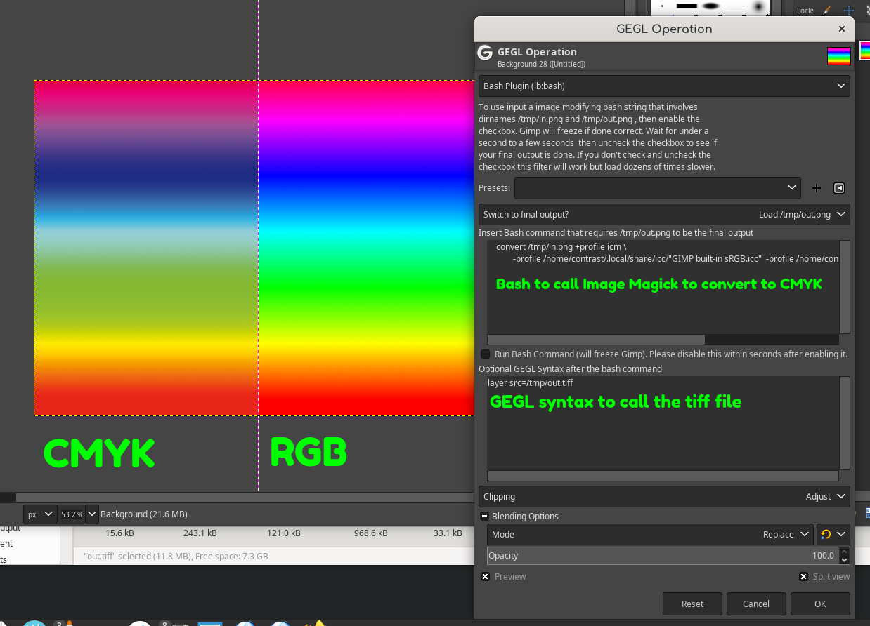

CmykStudent wrote:
contrast_: Cool! As a heads-up, PNG doesn't support CMYK (the CMYK colors would be treated as RGB on export). You would need to export as a TIFF or JPEG if you want the exported file to be treated as CMYK by other programs.
ok I'll use tiff
 Post subject: Re: GEGL calls GMIC, REMBG, AIs or any bash string with our bash plugi
PostPosted: Sun Feb 18, 2024 10:12 am  (#83)
Joined: Oct 31, 2020
Posts: 2025
ok, it worked for real. I need to retract the other two post.

@CMYK_Student
This may sound radical but could we see if there is a way to use Image Magick and my bash plugin as a dependency of Gimp to get CMYK preview support?

CmykStudent wrote:
contrast_: You should be able to do that already with the soft-proofing features, but you're welcome to compare and contrast with your method.
I had no idea this feature existed. wow it is much better then what I thought of.
I imported the CMYK icc from Image Magick and I can still edit in soft proof CMYK mode. Said file is here. https://github.com/ImageMagick/ImageMag ... g/cmyk.icm and it is open source and commercially permissible.
