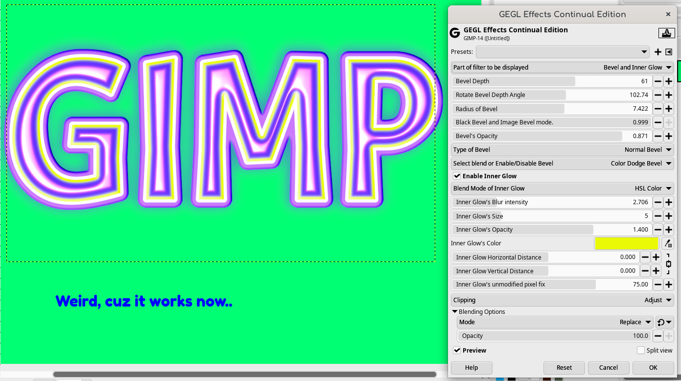

Drop Shadow and my plugin Inner Glow being applied non-destructively in 2.99.19
Their custom clors are remembered

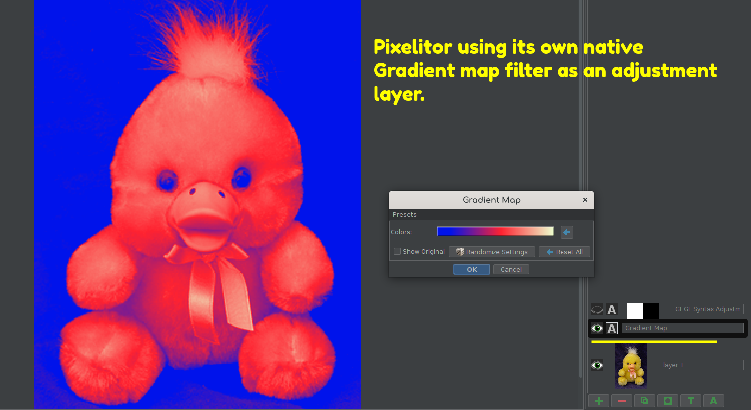

Here is a preview of adjustment layers in an open source program called Pixelitor. You have to enable experimental features to use them but trust me they are stable as I've been using them for almost two years. Pixelitor can also call GEGL from the command line bash and that too can be used as an adjustment layer, but it is very slow and syntax only (for GEGL and GMIC, not native filters, they are fast). In Pixelitor adjustment layers apply something like "gegl graphs" to every layer below them unless blocked out by a "normal layer group".
https://github.com/lbalazscs/Pixelitor
Pixelitor using its Gradient Map filter as an adjustment layer

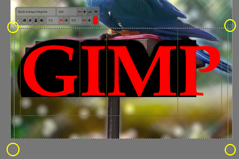

I triggered the out of bounds bug by making a composition with text and dropshadow then moving and expanding the text layer.
Please manipulate the text layers corners in hopes of triggering the out of bounds text bug yourself.
We can solve this bug. I believe in your CMYK Student!

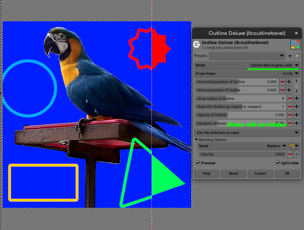

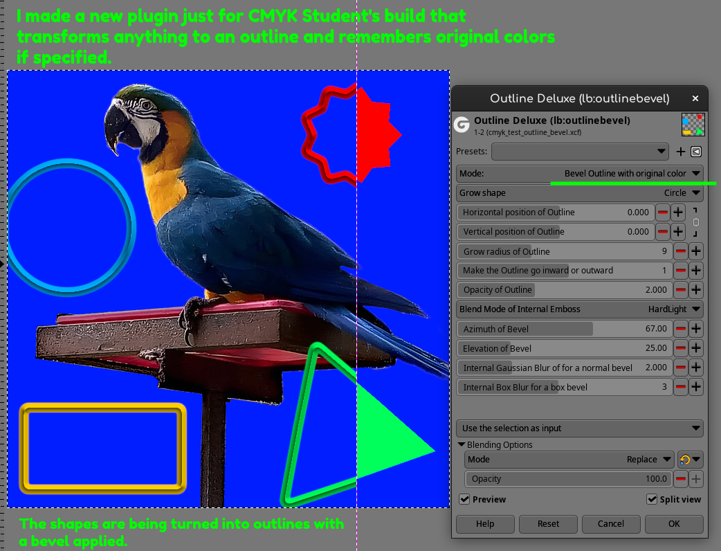

Congrats for the inspiration. CMYK Student's 2.99 Gimp build inspired me to make a new unreleased plugin that remembers the original color of an image before doing an "outline only" effect. Said unreleased GEGL plugin depends on two other plugins of mine SSG and Custom Bevel. Users can now use shape brush packs in Gimp and make real time non-destructive shape outlines or easy bevel outline only text. The plugin also works in Gimp 2.10 but it won't have real time brush abilities.
The technical reason for me making this plugin is so that 2.99 users could make outline only bevels on the same 'layer effect' setting without writing GEGL syntax.
Bevel Mode
Outline Mode
I will make a separate thread when this plugin is released, and due to the fact that Gimp 2.99x currently crashes most of the time when using layer src=/image_here.jpg in the GUI only, This plugin will NOT contain the ability to upload an image file. This would have been a trivial addition but I don't want to make any new plugins that use that feature until that bug is fixed.

Outline Deluxe plugin is released. Download below
https://github.com/LinuxBeaver/Outline- ... n/releases
It has code and binaries and will work on 2.10 and 2.99 but it is specially intended for 2.99.19. Usually I do not release plugins several hours after I make them. This is a quickie exception.
