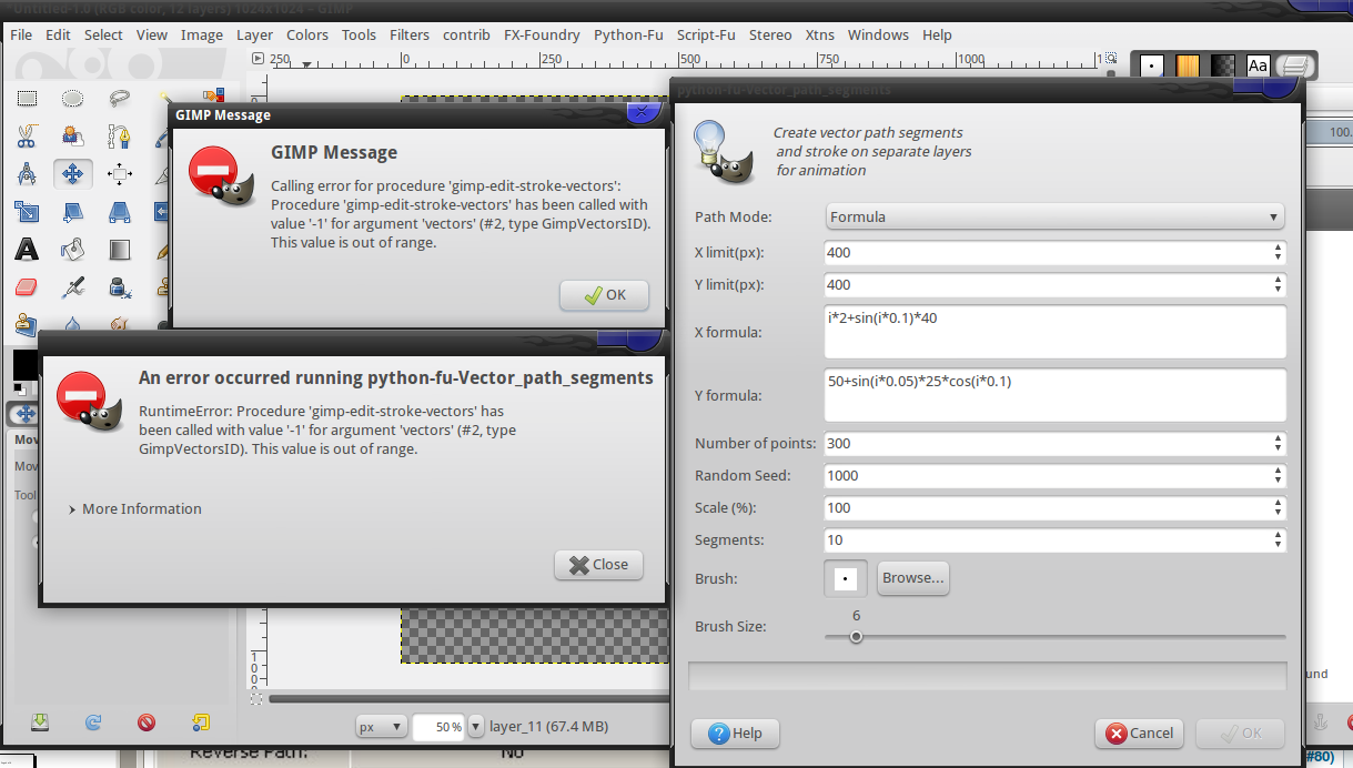

Thanks Rich that did it.
I had to use version 2, version 1 just would not work.
although I still get some crashes it does work :hehe
I did manage to try it out and make a line, now to fool around with the formulas.
Here is one error message I got in case anyone wants to know.
but even with this error it created the line
So it's all good, as long as it works I'm happy,
I'll try out more later on, just glad to get this working finally :)

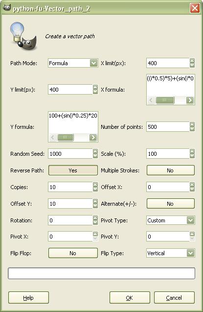

This is kind of funny - i forgot (remembered now- alt + arrow up or down), how to move the dialog around so i could see the ok button to invoke the script.So i was tabbing 10 times from offset and i should have been tabbing 9 because i kept hitting cancel when i would hit the enter key. :lol
B and P is there anyway to fix the dialog UI so that it isn't so long or tall? Maybe set the ui like Word Art? :)
This is the dialog window on my PC monitor.
Ok i changed the 2 lines.
#194 and #233
to this
        for i in range(int(copies)):
and it works great in 2.8 now. :) :bigthup

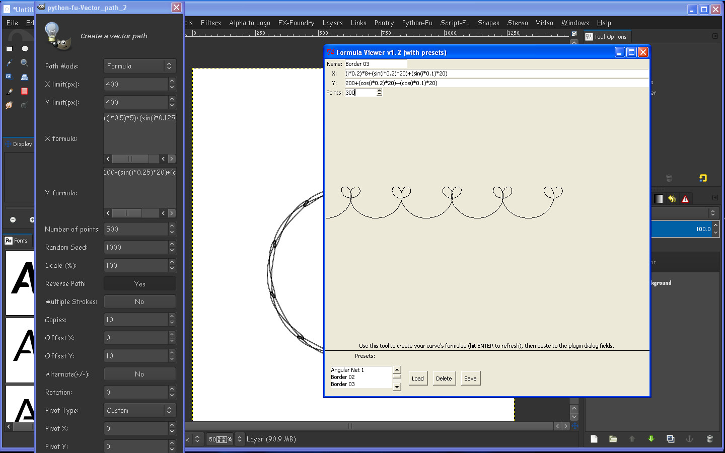

Honestly, it's a pain to do custom dialog. in Word Art I had to paste entire gimfu.py in, so I could override dialog. That's the only way I know how to do it. Maybe I'll give it a shot, can't promise though.
Here is a hack you can do if you're up to it. Edit gimpfu.py as per attached file (left side is the original gimpfu.py, right side - edited), and you'll all your dialogs will have two columns. See screenshot
gimpfu_hack.zip [26.52 KiB]
Downloaded 202 times

Hi guys,
thanks for all your feedback. I will clean up some code and post updates the soonest.
I am also working out yet one more feature - I'd like user to be able to generate a rectangular path/border.
Also, there will be a Formula Viewer update.
BTW, there is a bug in Formula Viewer code:
            except:
                msg.showwarning("Error","Your formula has an error")
                break
            self.plotOne (canvas,Width,Height)
move last line one TAB to left (out of the loop),
to read
            except:
                break
The App will update MUCH faster.
Sorry for that mistake on my part. Of course it will be addressed in the next update.
