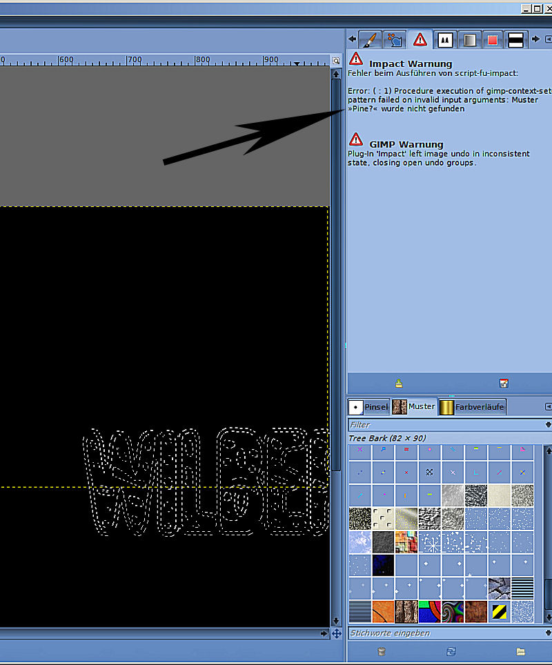

Hello,
I always get the error pattern " Pine " unreported found .
What can I do?
Regards Hardy111
I use: Gimp 2.8.16
G'Mic 1.74

PostPosted: Tue Jun 28, 2016 8:59 am  (#87)
same environment, just downloaded the script and tested, both as Logo and Alpha-to-Logo
no errors
in any case: do you have the pattern called "Pine"?
(but I do not see a pattern parameter in the script)

PostPosted: Tue Jun 28, 2016 10:01 am  (#88)
Joined: Jun 16, 2016
Posts: 137
Hello,
which is a parameter " Pine ? " but I have installed
the pattern " Pine.pat " . I do not know why the script
is not working !
Greetings from Minden Westfalen Hardy111
(set! bkg-layer (car (gimp-layer-new image width height RGBA-IMAGE "Background" 100 NORMAL-MODE)))
(gimp-image-add-layer image bkg-layer (+ (car (gimp-image-get-layer-position image layer)) 1)) ;under
(gimp-context-set-foreground '(0 0 0))
(gimp-drawable-fill bkg-layer FOREGROUND-FILL)
(the-stroke image bkg-layer 0 color 100 0 size position '(127 255 255) '(127 255 127) 0 "Sunrise" 30 1.00 0 0 "Pine?")

PostPosted: Tue Jun 28, 2016 12:33 pm  (#89)
maybe Graechan (the author) can read and answer...
 Post subject: Re: ImpactRel5 Script
PostPosted: Tue Jun 28, 2016 9:39 pm  (#90)
I have awaken from my deep slumber, Answer is the pattern 'Pine?' is not used in the script, if you look below you will see that only 'color' is used "have you changed any parameters in the script

thanks Graechan.
It was my suspect too, because I used it without any error and there is no reference to patterns in the script as downloaded

PostPosted: Wed Jun 29, 2016 12:05 am  (#92)
Posts: 137
Hello,
I loaded the script again , but to no avail . It stops when running with a black layer . My brother Gimp tidy
and a few scripts deleted , that is the reason ??
Regards Hardy111
