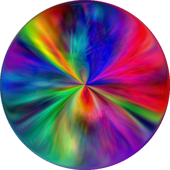

I was attempting to simulate Light Probe images, which can be thought of as taking a picture of the reflection in a mirrored ball (like a silver Christmas tree ball). Not all images seem to work well as Light Probe Images for emaps. Some need lots of smoothing, at some point during the process, to produce good results.
I've been playing with a script to do this, which basically does what I manually outline below. While this method produces a cool effect, maybe someone can offer suggestions on how to improve the technique for simulating Light Probe images.
Menu: Filters/Distort/Light Probe Simulation
File comment: Light Probe Simulation Beta V0.90
light-probe-simulation.scm [3.26 KiB]
Downloaded 281 times
Note: You can also get interesting results by running the script twice: once at 10% Circular Warp Depth, then on that result, run again at 100% Warp Depth.

The problem with this method is that it doesn't simulate light probe made with mirrored ball reflection.
Pinching in the middle should not occur, it's like a Universe inside out. Added grid for demonstration
Pixels in light probes don't really converge, gives incorrect reflections.
Maybe it's not important for text reflections using Bevel Reflect plugins
but it wouldn't work as a general purpose light probe creation.

Yes. I'm aware this is not a perfect simulation, but more of an approximation. I was actually hoping for constructive suggestions on how it might be improved or alternate methods of achieving the effect, perhaps like multiple levels of lens distortions or something along those lines.
Thanks!

I hear you Tux. I've searched for the solution myself not so long ago.
None is good enough. Approximations.
BTW, your script is similar to what GMIC>Deformations>Circle_transform does.
Surprisingly, not so many software programs can convert panoramic HDRi (or just jpeg) images into a [physically correct] light probe.
HDR Shop is the only program that I know of. I was told that Genetica can also do the trick. They are all commercial, of course.
No wonder 3D artists still stick to DSLR cameras and gazing balls. :hehe
