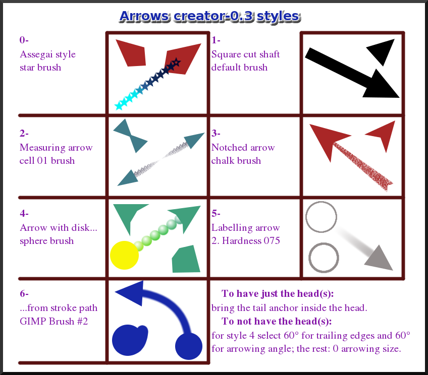

Hi,
For those who have adopted GIMP-2.8.14 on Linux or Windows this release candidate ArrowsCreator-0.3
takes advantage of the brush correction in it, being more flexible at the price of not working for GIMP < 2.8.14 .
Among other changes there is new shape head control for style: "Arrow with disk joint".
Merry Christmas to all.
Permit linux-root install for user group and use a background colour for coloured text in UI. (2016-12-09)
Add a patch for a missing case, of head length greater than arrow length, for arrow style 6.
(2017/02/25)
File comment: ArrowsCreator-0.3.5 (2017/02/25)
ArrowsCreator-0.3.py.zip [21.95 KiB]
Downloaded 4993 times
File comment: Style examples
