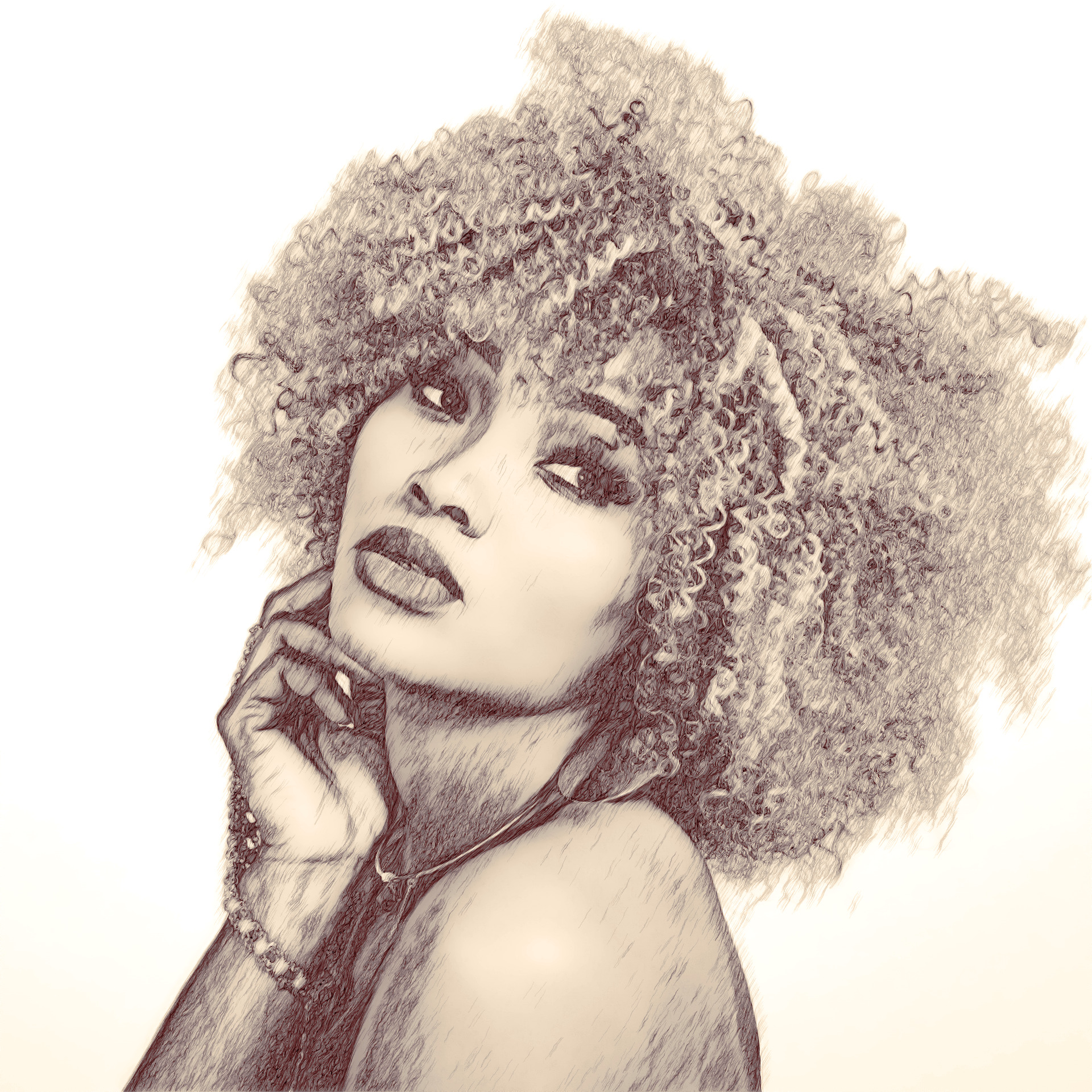

Problem is Ink Wash usually is so slow.
I just doing the tut changing Ink Wash by Freaky B&W (default values):
File comment: Freaky B&W instead of Ink Wash

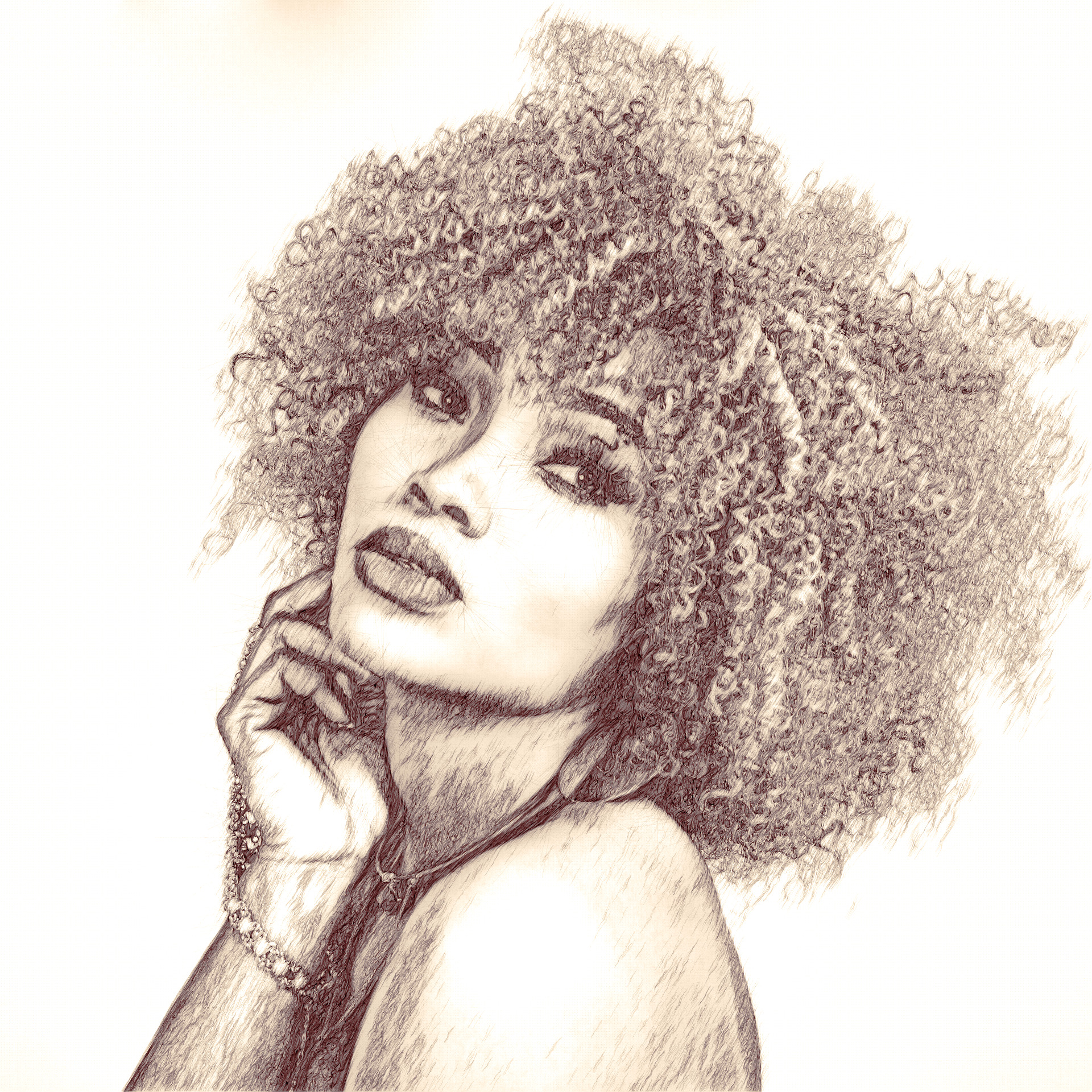

File comment: Tran script, 1920 x 1920

Very nice jamac4k. Thanks again, appreciate it. Perhaps tin can alter the plugin.
