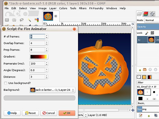

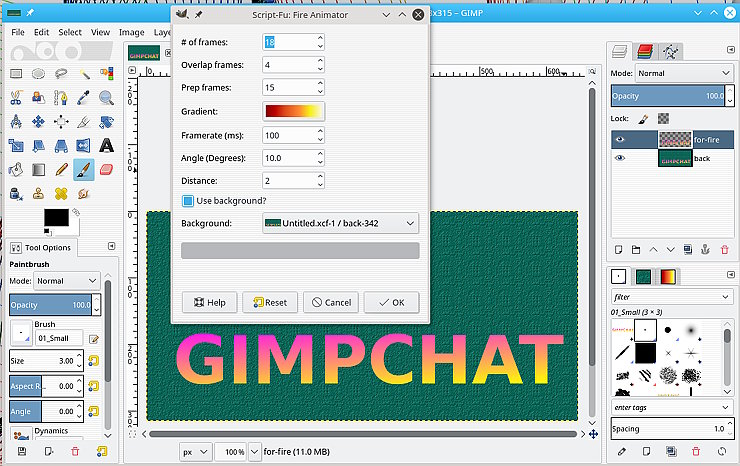

The basic is :- Use a layer with a transparent back. This example, coloured in text.

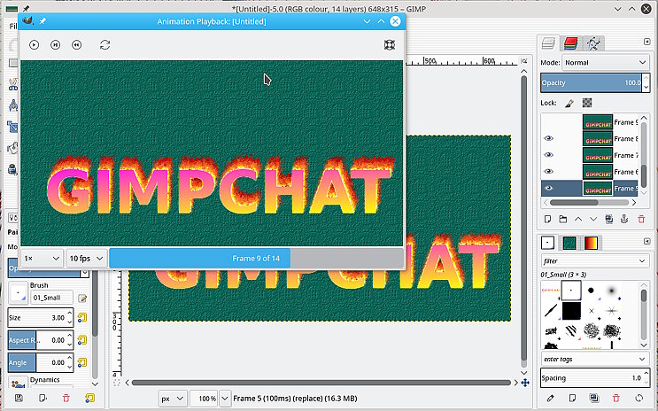

If you accept the defaults, then the result is an acceptable animation with a black background.
If a different background is used as in above example then with the default gradient 'incandescent' there is, IMHO, a nasty black edge. A slightly better gradient shown, you will have to make your own.
Even then some black creeps in, I had to delete the first 4 frames to get something reasonable.

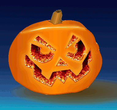

What is there to explain. As earlier post, you need some transparent areas in your image.
Whatever happened to giving it a try?

In the reply that you had earlier, all I saw was the flaming Halloween jack o'lantern. You didn't say that transparent areas were needed in the image. Now that I see how you got the image to flame, I understand it now. Thanks, Rich. :)
