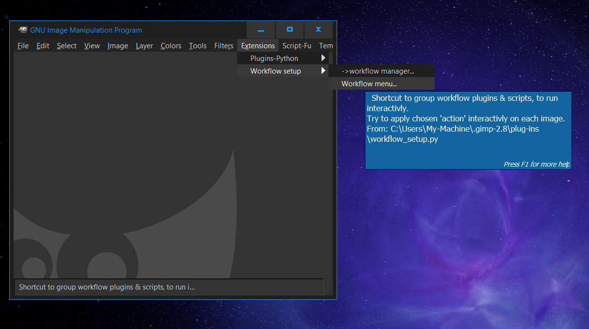

Wallace where did you find the menu
 Post subject: Re: 'workflow_setup' plug-in
PostPosted: Sat Oct 03, 2015 12:05 am  (#4)
Posts: 14166
Does this help...

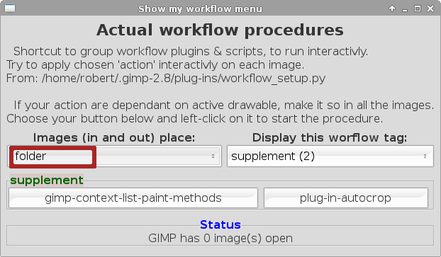

I don't understand Rob_brz1,
I'm not using any kind of folder in the Workflow menu, nor do I have one that I can use?[/align]
With the first "workflow_setup.py" you could select 'folder' instead of GIMP, see the screen capture in the attachment. Today after the edit, in the new "workflow_setup.py" you couldn't, only GIMP is active.
The 'folder' one need more work.
