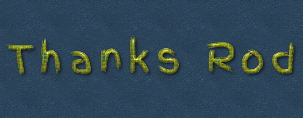

Thank you Rod, nice results using your Reptile Effect Filter. :) :bump

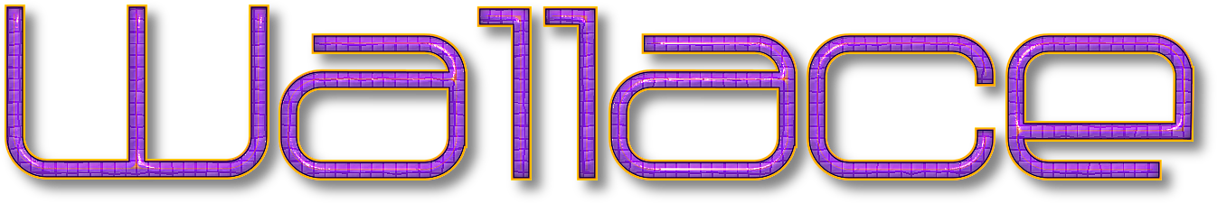

Also, test on shapes. Nice look, too. :)

Looks like you made a very small inner size selection. :) Still looks great though
yes, you are right Rod, sorry it had an imperfection. I did another using your nice useful filter. :) :bigthup :coolthup
I used Octagons & Squares option.

PostPosted: Sat Dec 05, 2015 9:53 am  (#13)
Posts: 16164
Not sure what the problem is there O i will look into it. Possibly the settings for shape size.
Here is another effect from spacing the letters before running the filter. :)
 Post subject: Re: Finished the Reptile Effect Filter
PostPosted: Sat Dec 05, 2015 9:57 am  (#14)
Posts: 16164
O i tried a larger scale size (30) for the image below and it looks ok. So that is probably the solution.

PostPosted: Sat Dec 05, 2015 4:48 pm  (#15)
Posts: 14165
Check it out...Image

PostPosted: Sun Dec 06, 2015 5:29 am  (#16)
Posts: 16164
Check it out...[ Image ]
Nice Wallace! :bigthup
PostPosted: Sun Dec 06, 2015 5:54 am  (#17)
Posts: 14138
I like this filter a lot Rod. Nice result Wallace, well done! :hi5
