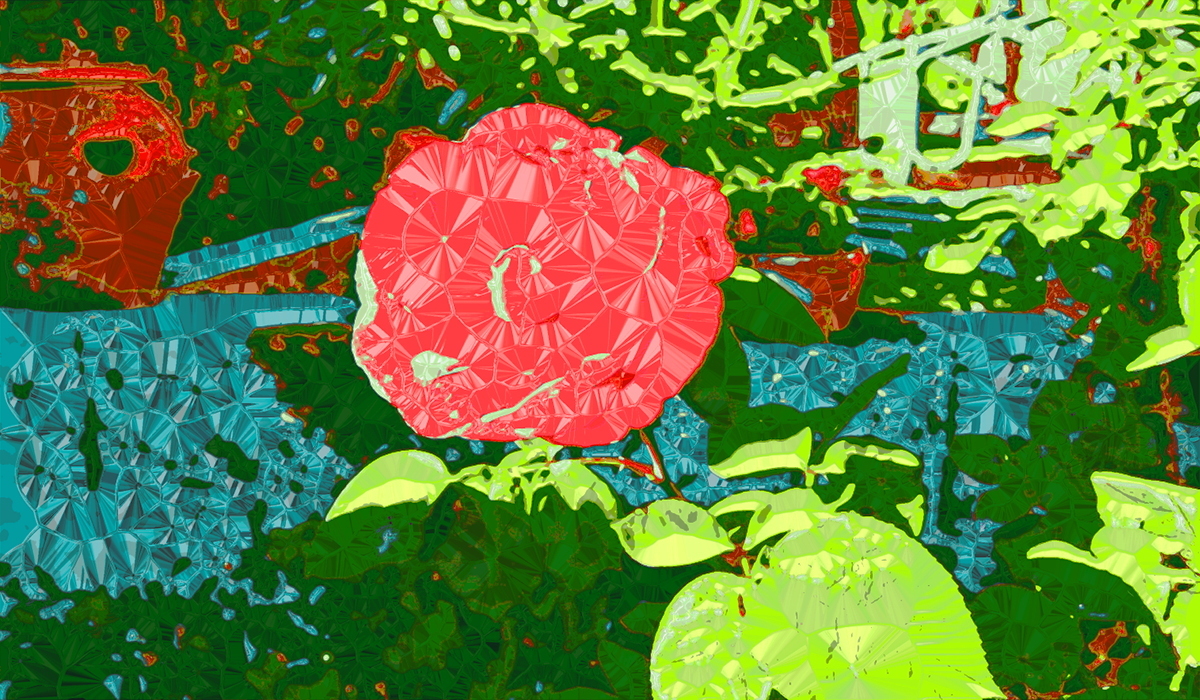

an example using 8 colours

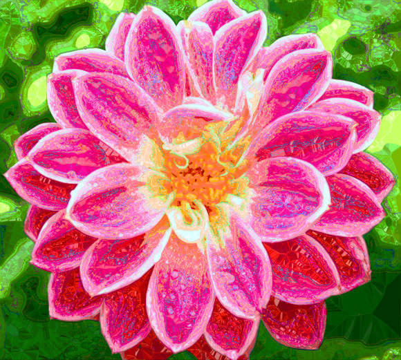

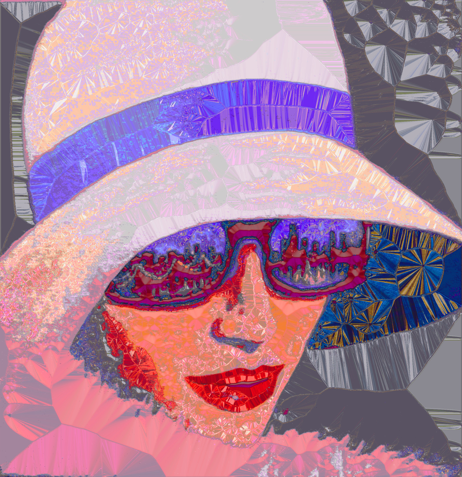

Thank you so much Dinasset, for me it has been a real pleasure and joyful to test your new "Crystallizing an image"
Let me input in your thread some samples.
Thanks a lot. :jumpclap :bump

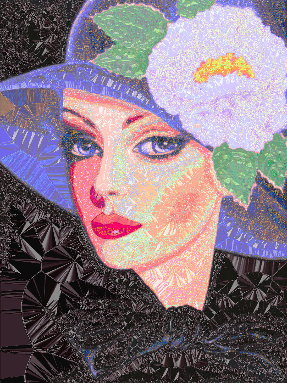

a few more. :)

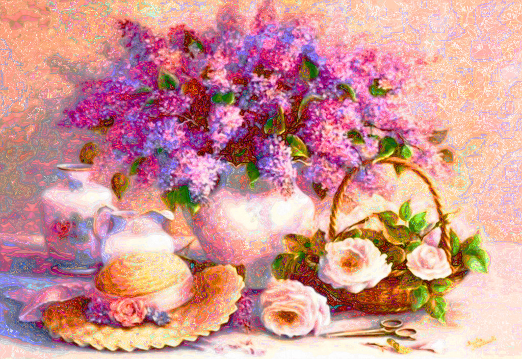

While I did another samples. I love the results. :)

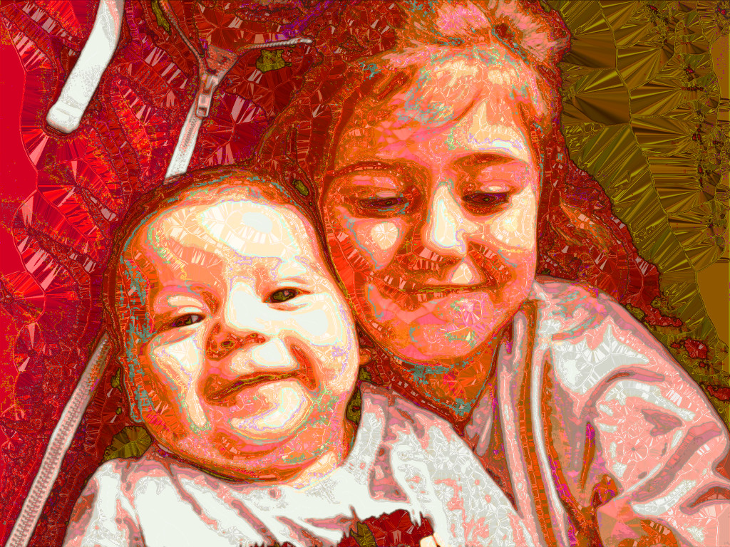

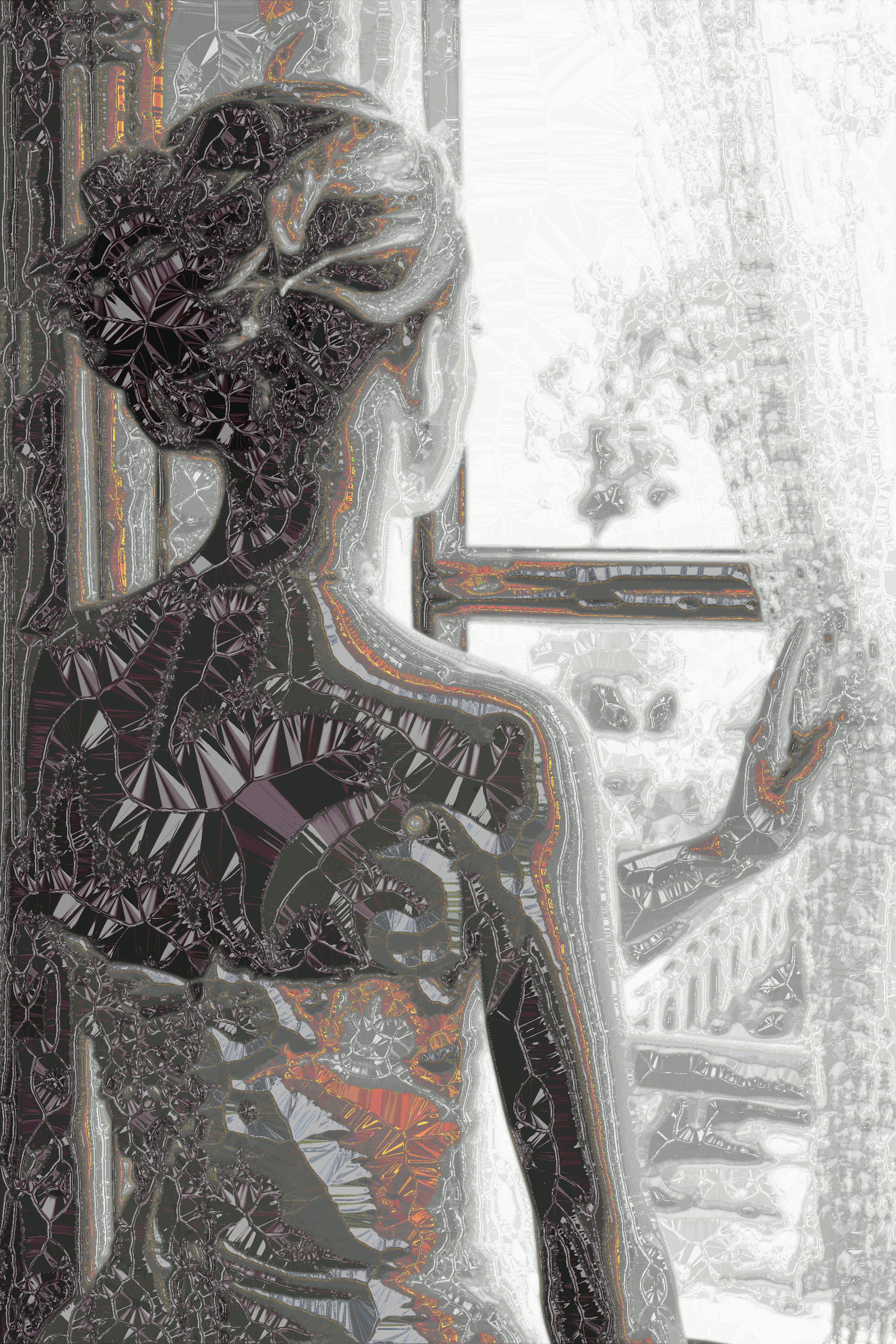

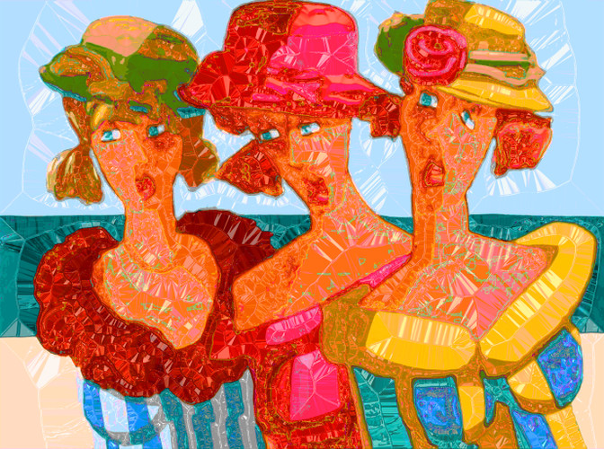

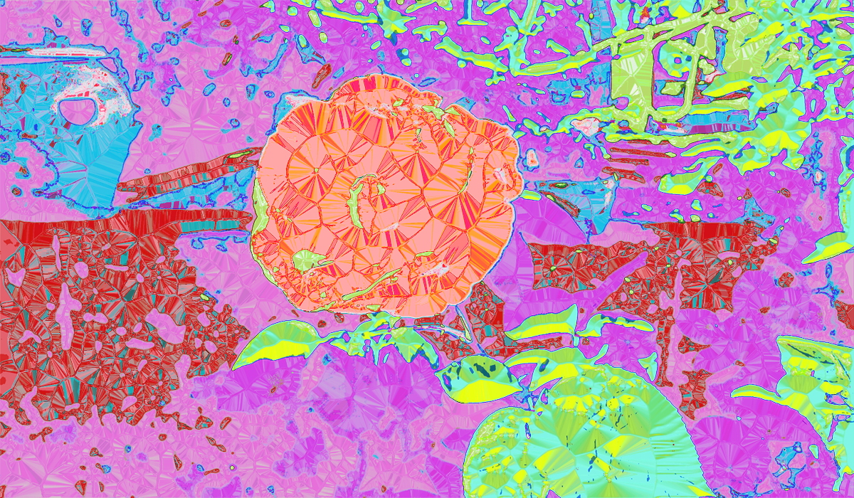

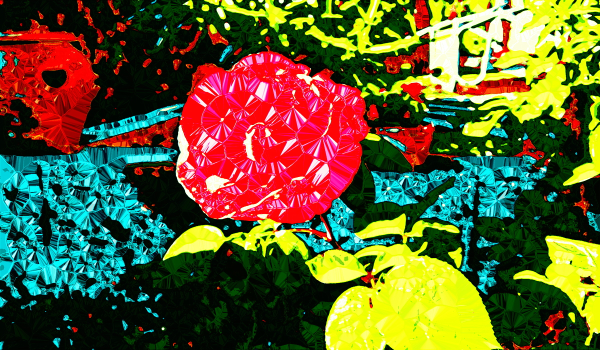

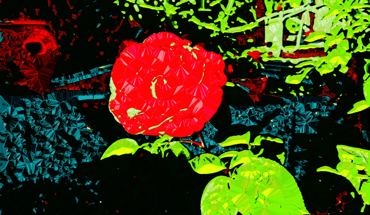

as usual, in my filters I let as default "Flatten = False", so the user has the full set of layers available.
One can easily play with mode on the top layer, to get different results.
Here some example (same photo, only changed the top layer mode)

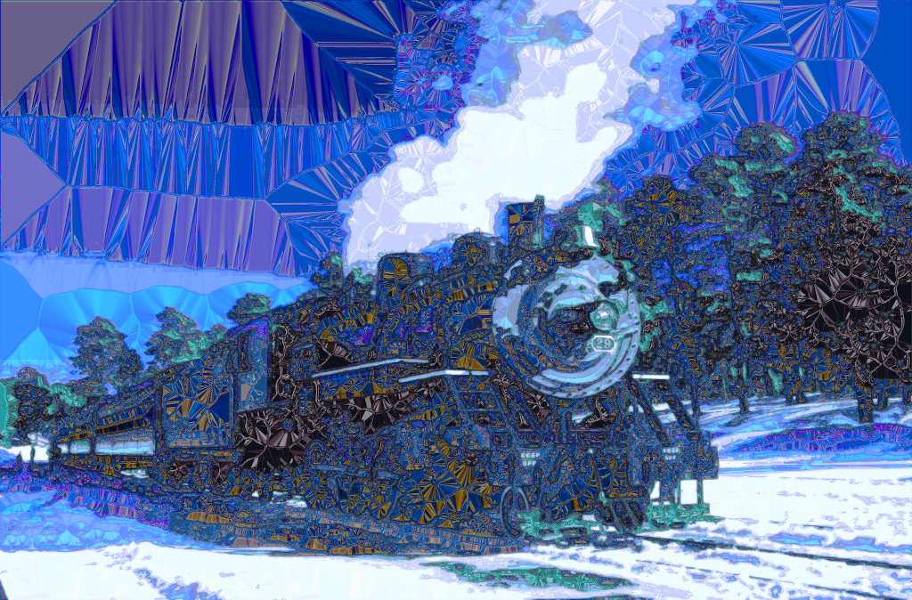

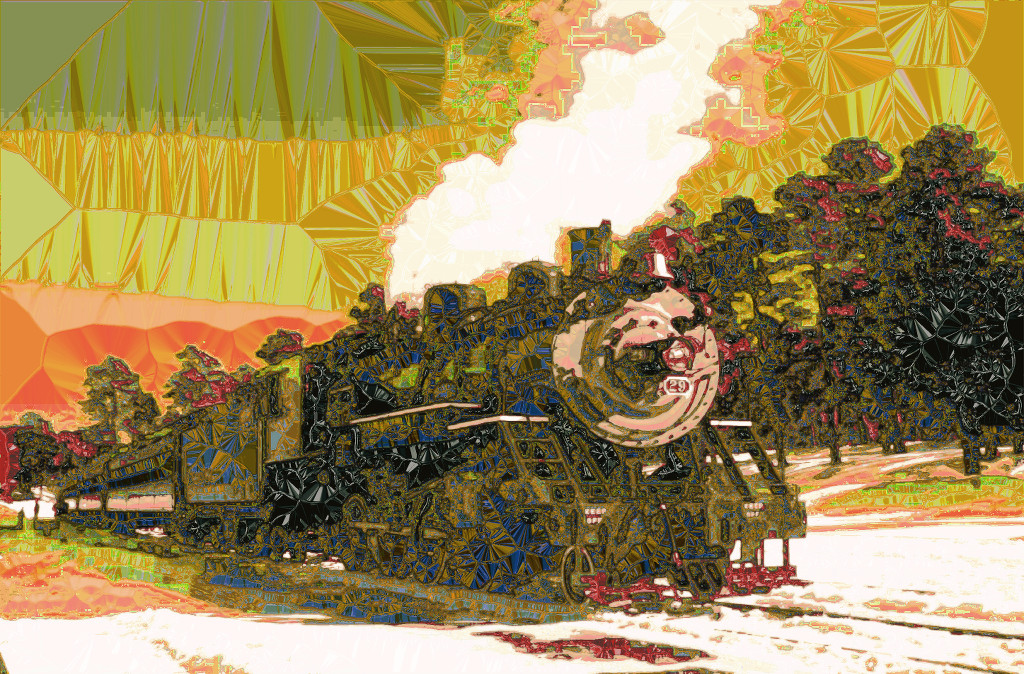

Really nice to change the layer mode. :hi5
steam-locomotive-wallpaper-12colours-overlay mode.jpg [ 497.75 KiB | Viewed 2286 times ]
