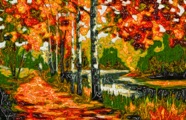

a few examples
the names suffixes specify:
- the number of colours used (12, 16)
- the image dimension (W+H=3300)
- the mode applied to the top layer (screen, as per default, or overlay)

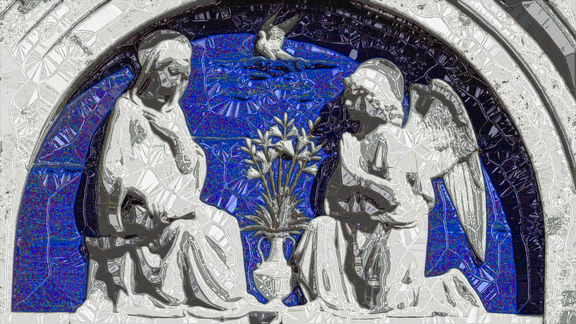

the last one

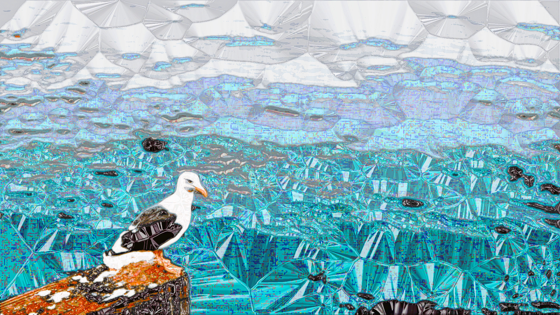

Thank you so much Dinasset. You always look for perfection. :clap
Lyle, your result is awesome. :clap

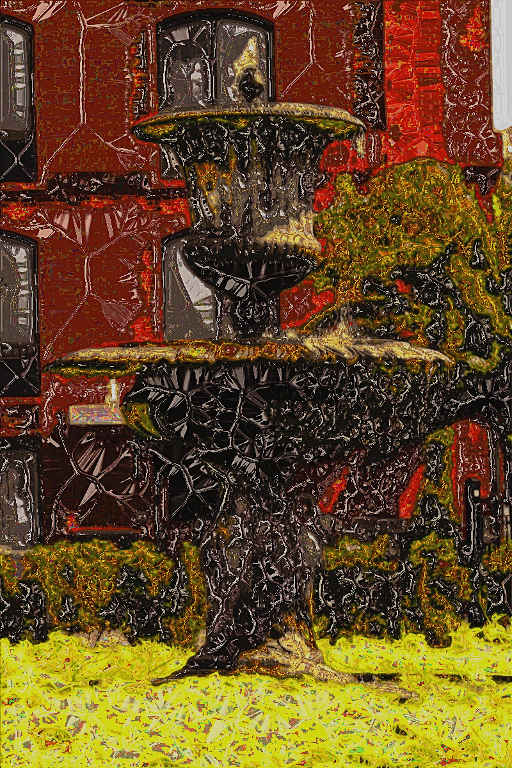

First attempt with new script:

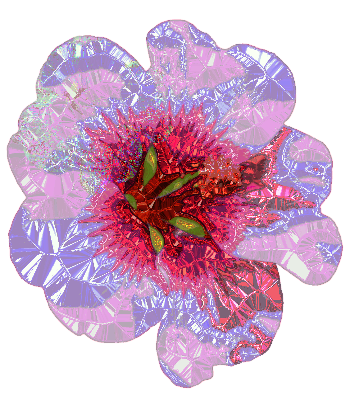

Nice one Pat; now Dinasset has ironed out any issues I gave the script a whirl ...
started with ...
... preferred outcome
... played with the above 2
Thank you Dinasset :hi5
