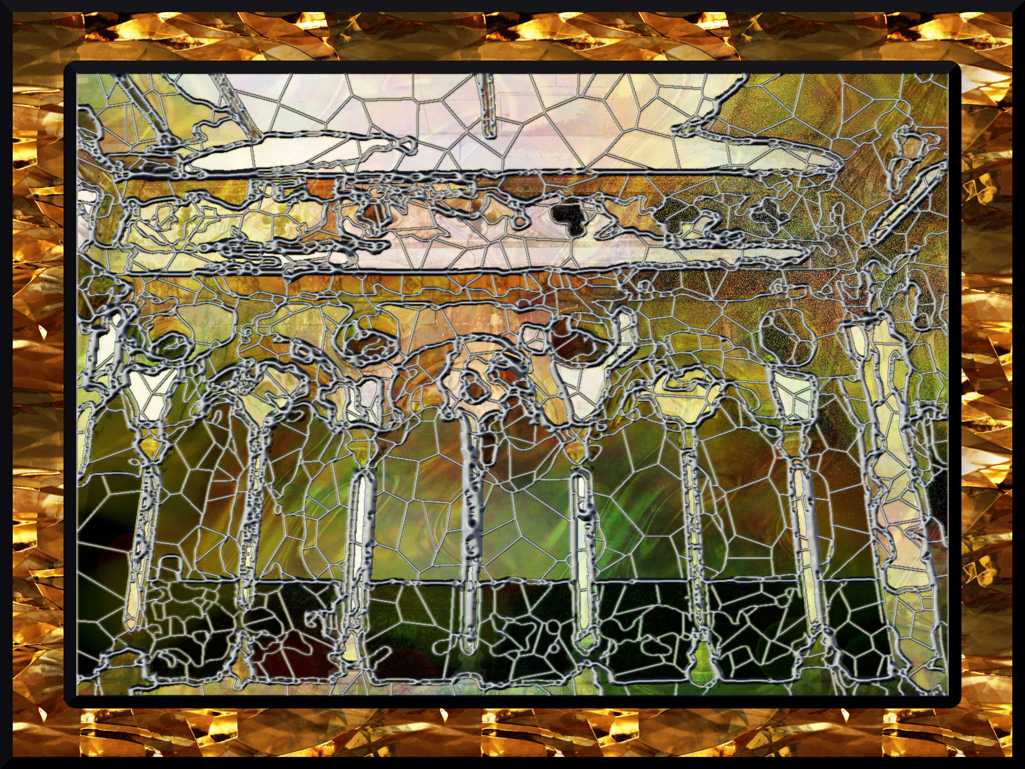

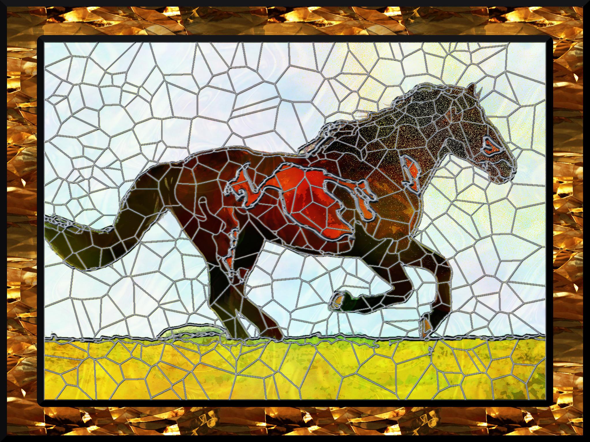

and these.

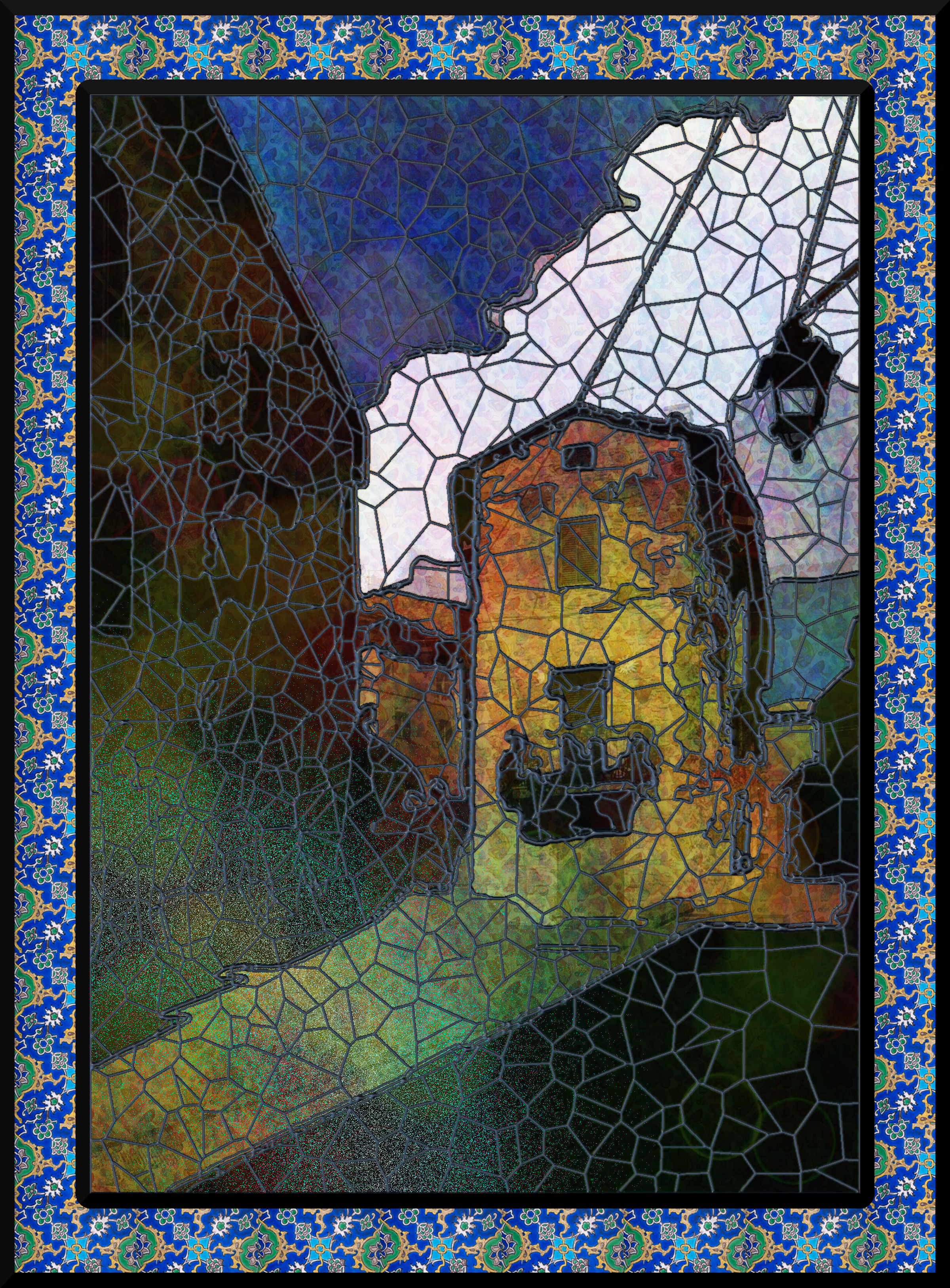

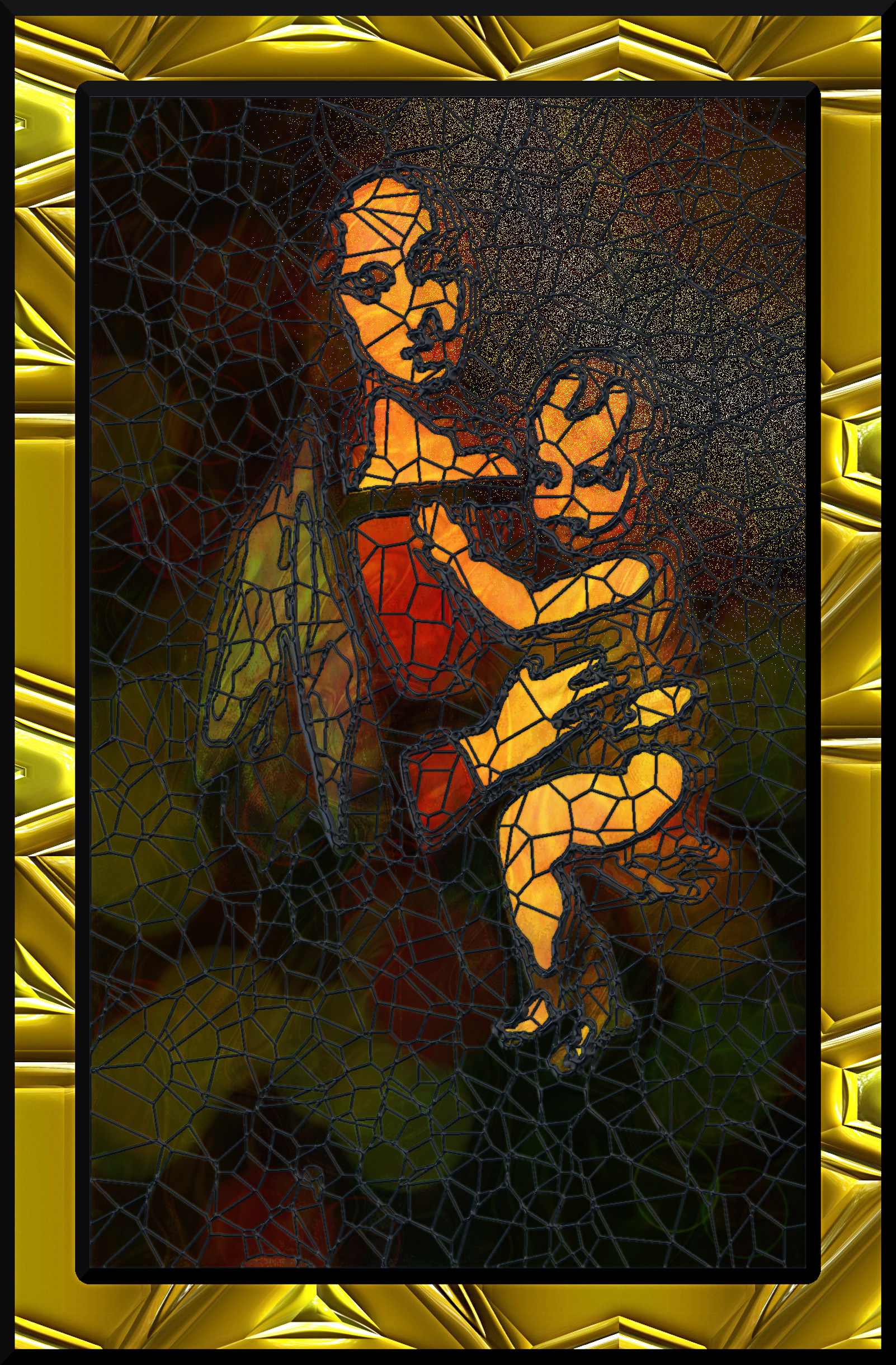

Thank you Dinasset for your hard work, but it's great! :clap

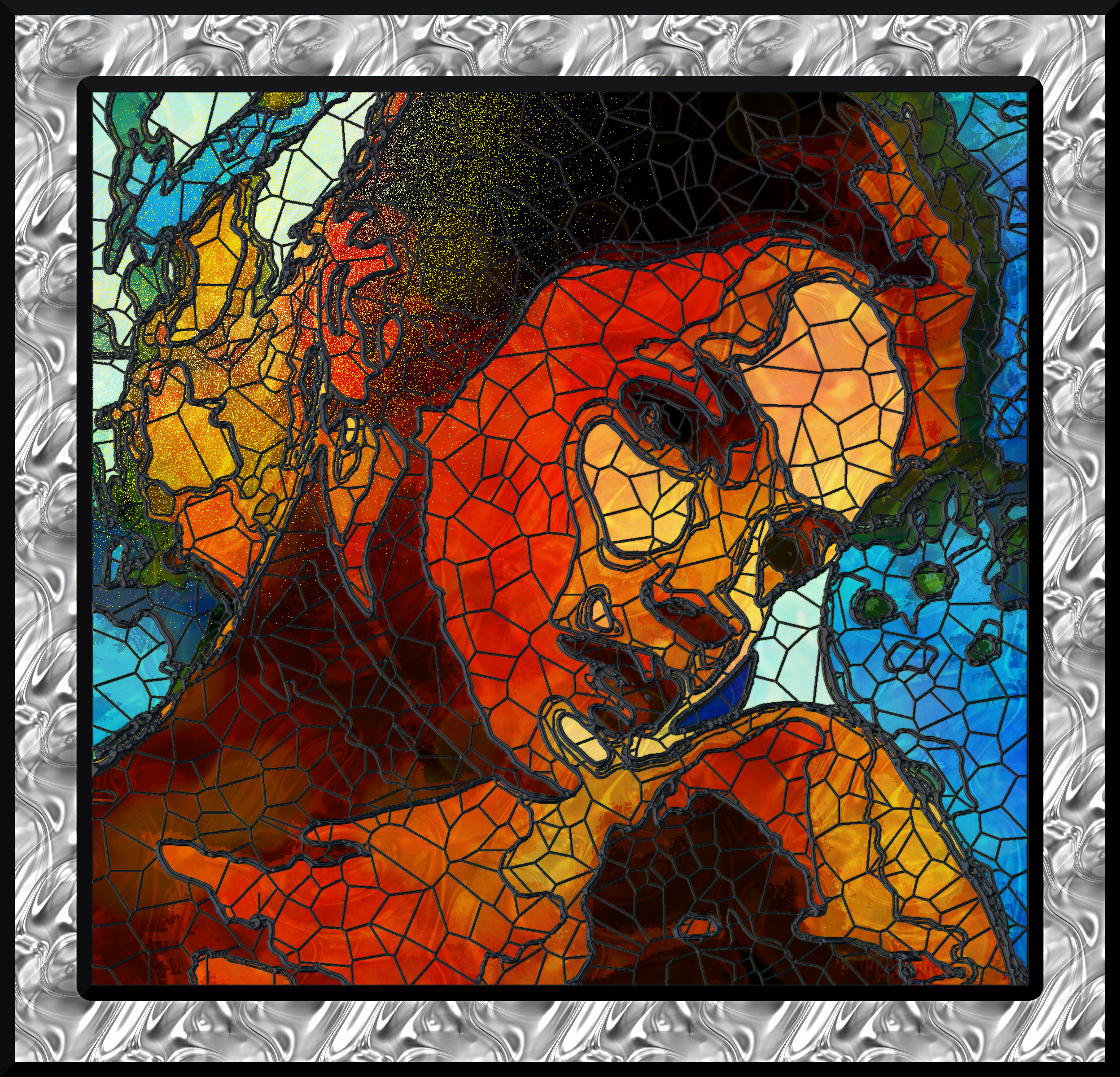

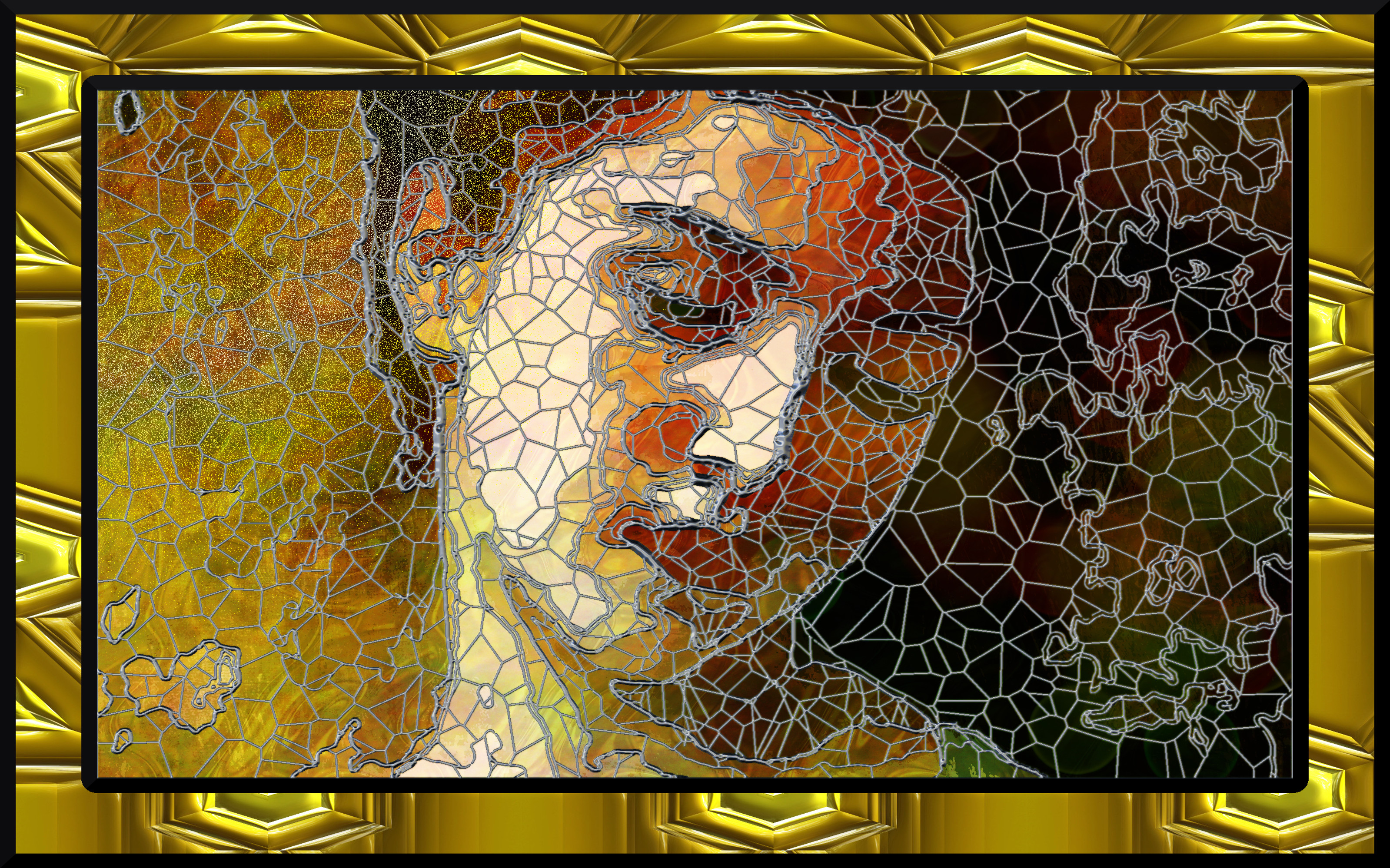

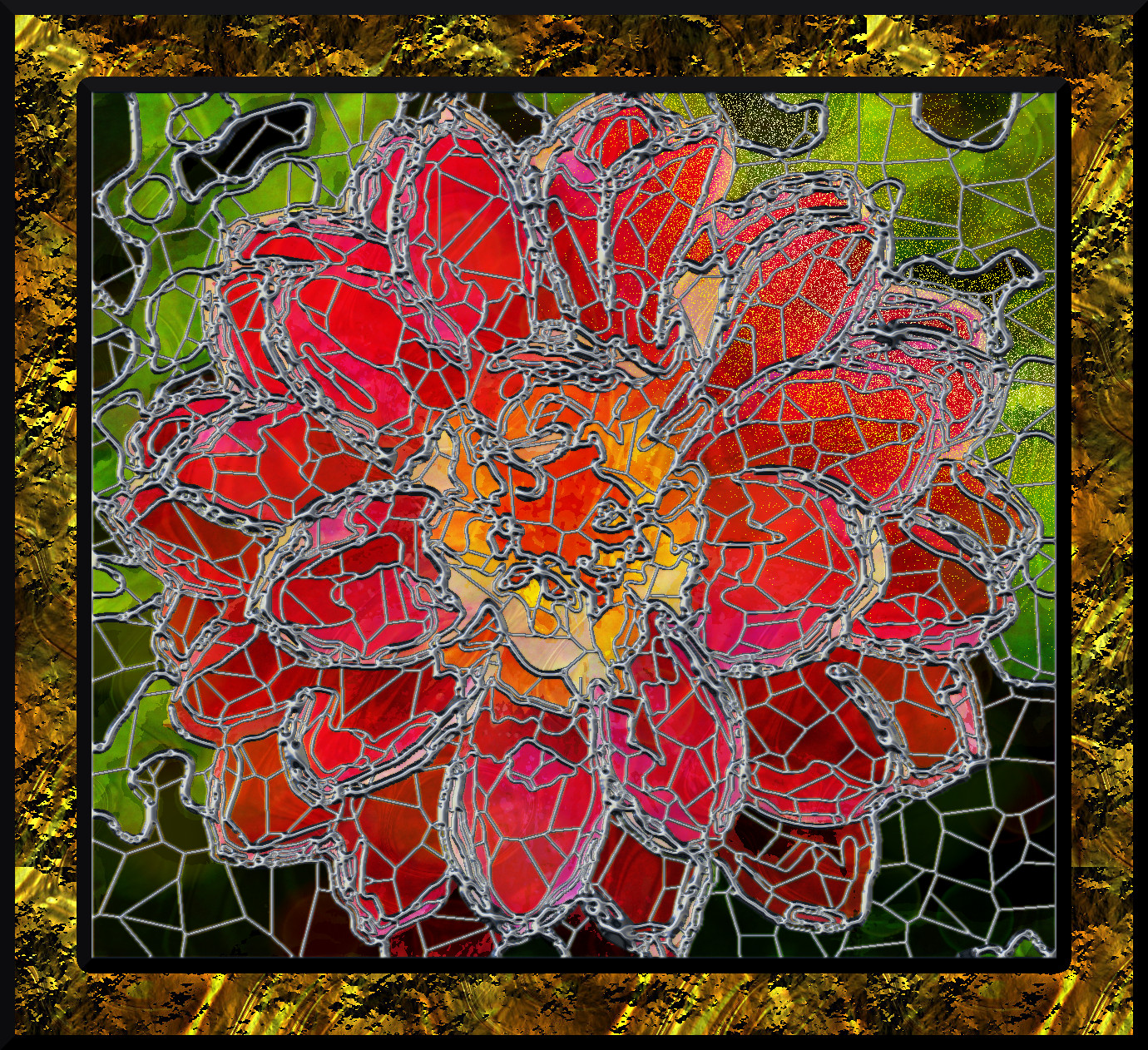

...and my (also traditional) red rose

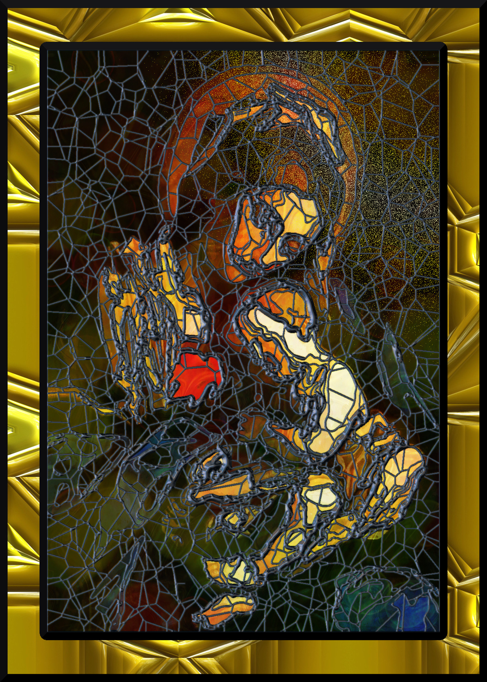

I applied it on these too. :)

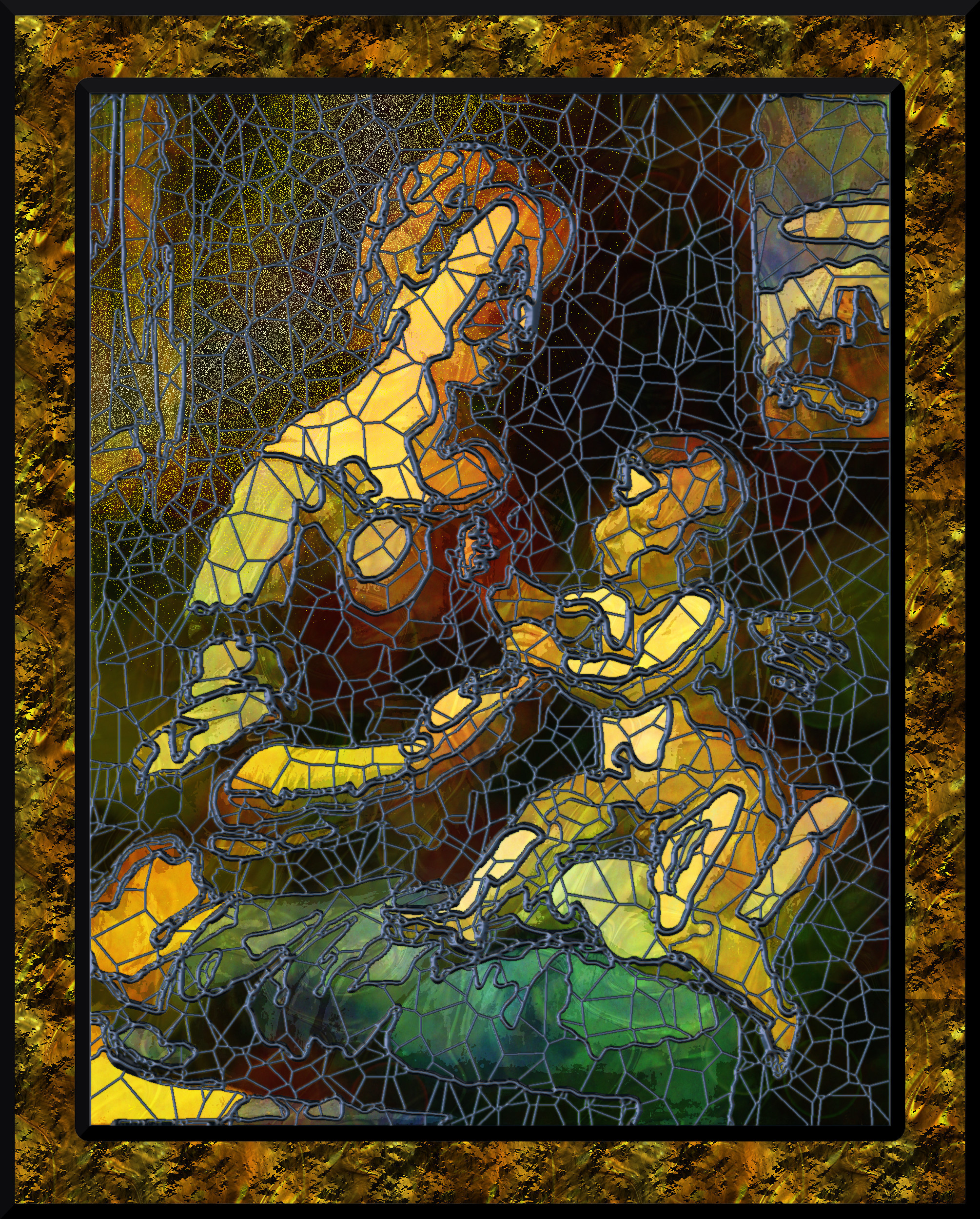

Raffaello,_madonna_sistina_MosaicStainedGlass-D.N.jpg [ 1.03 MiB | Viewed 10194 times ]

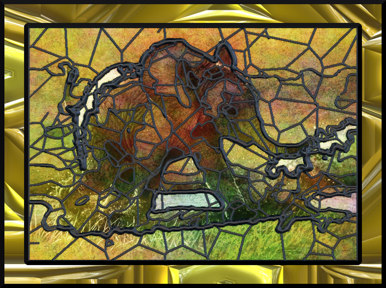

PostPosted: Fri Mar 11, 2016 1:27 am  (#20)
first attempt on Picasso: changed tilesize to 10, colours to 9
you may change other parameters at your taste, but the image in itself sounds quite acceptable to me
