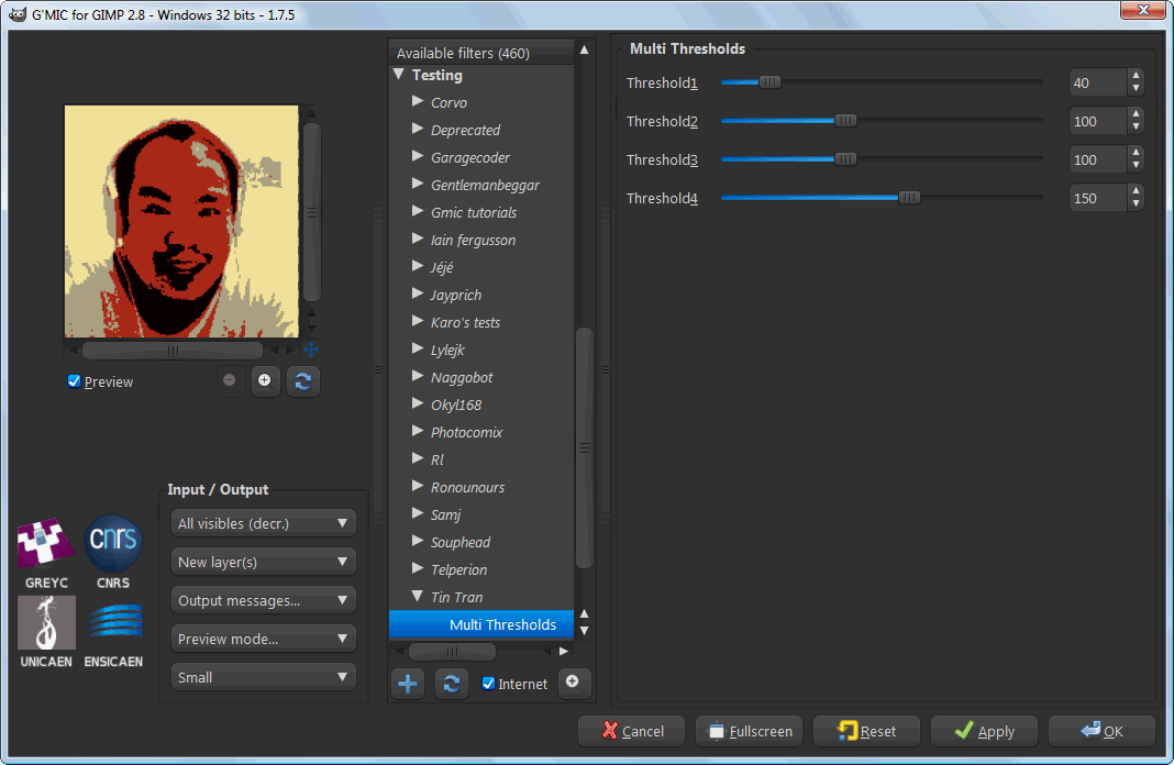

And then you'll have an available filter in G'MIC that looks like this.
You can control these 4 thresholds on the fly and preview the result (a little slow but i am just happy it works).
Then after applying, you can run the Obama Posterize scheme script
And the result will reflect the manual multi thresholds that you used.

It works great in Vista 32 Bit (for GIMP 2.8.18 i 2.9.5)
I changed a location in the menu GMIC.
Thanks Tin. :jumpclap
