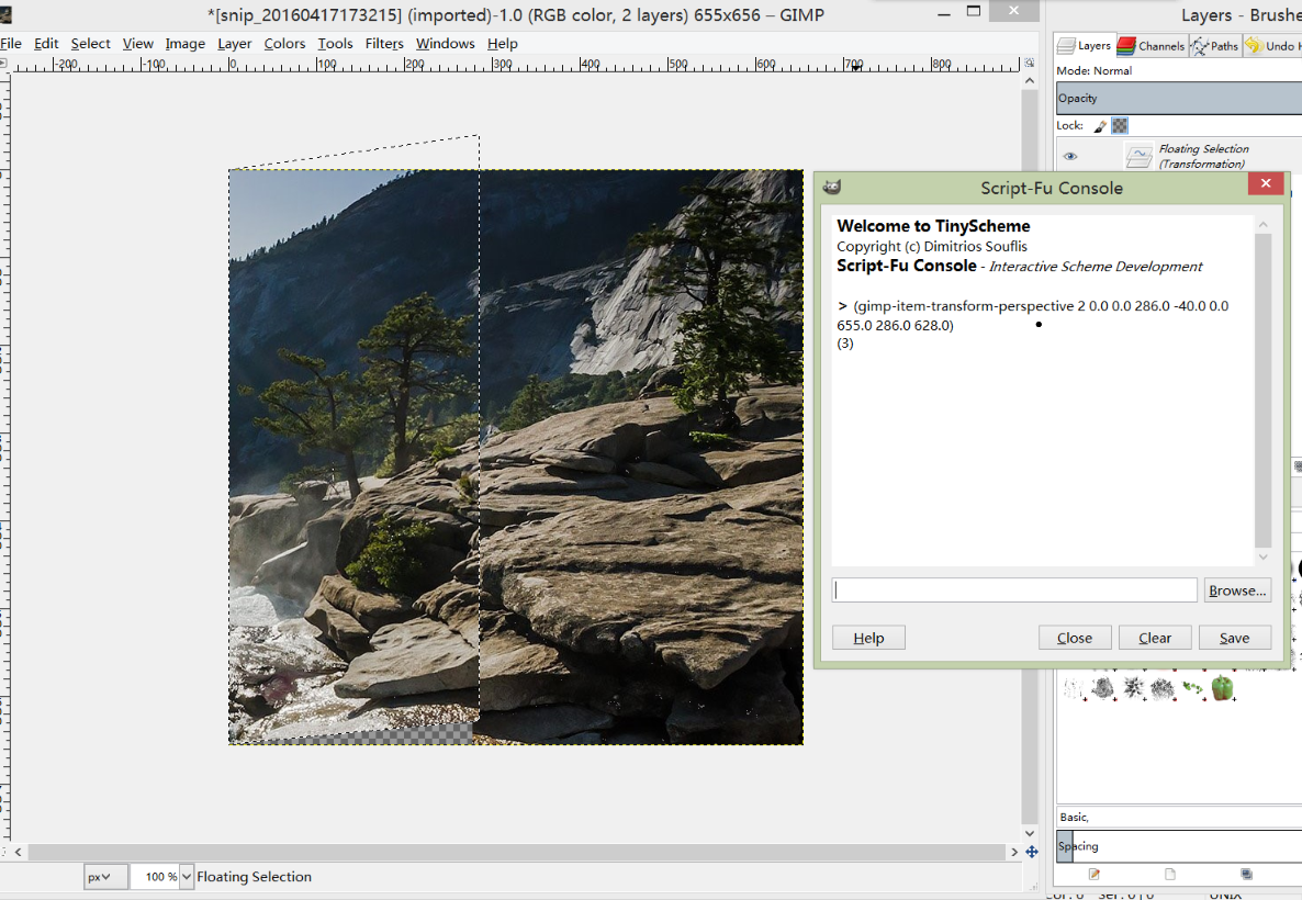

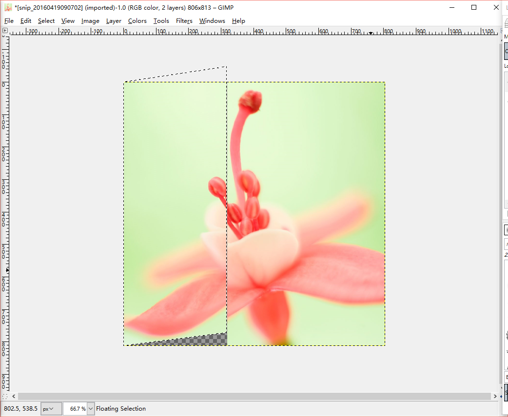

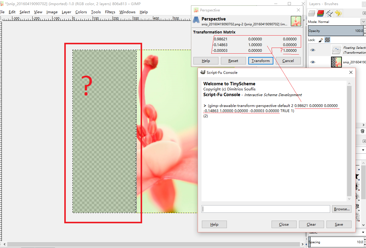

Thank Odinbc and ofnuts for the reply, but I still don't quite understand.
I want to use the script, just confusing don't know its corresponding argument.
