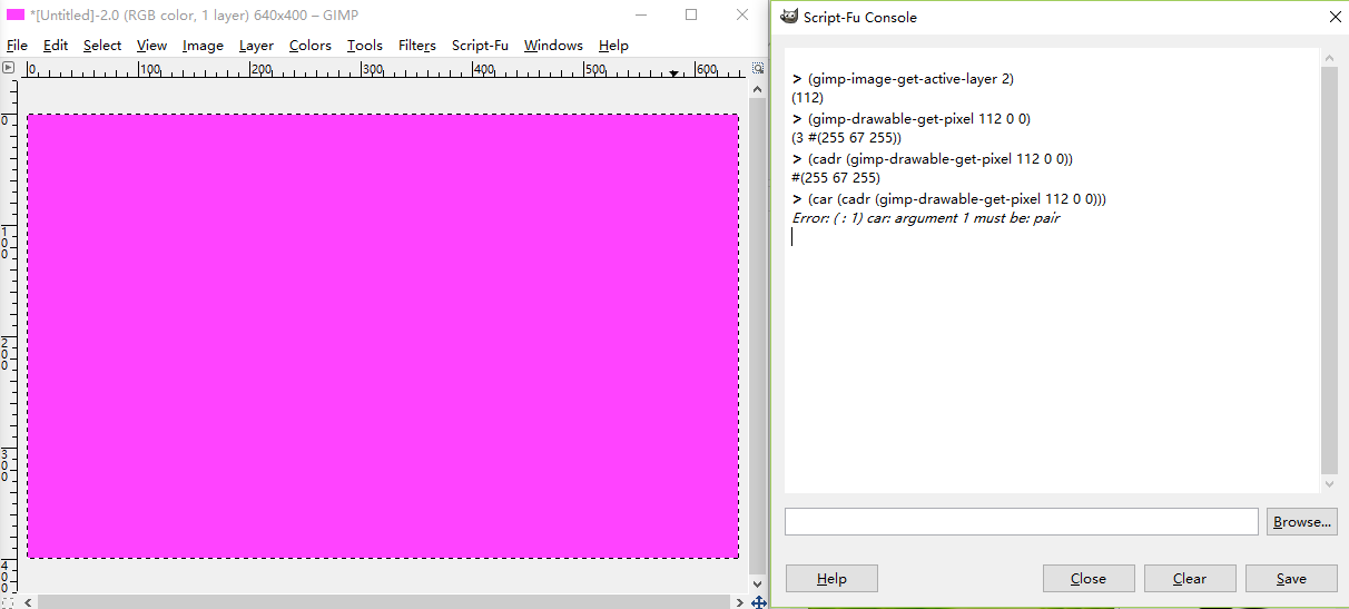

How to write invert Colos in the SCM code, but instead of calling the plugin in the Invert.
I tried to use (gimp-drawable-get-pixel drawable x-Coord y-Coord) for each pixel value, again with 255 minus the per-pixel values, and then use the (gimp-drawable-set-pixel drawable x-Coord y-Coord) to redraw, but in execution (GIMP-drawable-get-pixel drawable X-Coord y-Coord) when an error do not know how to extract the RGB value, please advise. Or a complete SCM code available for reference.

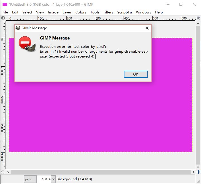

I'm using (gimp-drawable-set-pixel drawable x-Coord y-Coord NUM-channels pixel), parameter error, don't know how this argument is correct

It still doesn't work. (gimp-drawable-set-pixel drawable x-Coord y-Coord NUM-channels pixel) pixel parameters do not know how to write

 Post subject: Re: help invert color
PostPosted: Sun May 29, 2016 10:04 pm  (#18)
Posts: 4527
you can't do math in a static list, you'll have to use (list) function to construct a list.
gimp-drawable-set-pixel accepts an array/vector instead of list so you'll have to use (list->vector) function
and also it doesn't update the front end for you to see the change until you call (gimp-drawable-update) or manually hide the layer and show it again.
try sample code below
(set! RGBvalues (list (- 255 REDvalue) (- 255 GREENvalue) (- 255 BLUEvalue)))
(gimp-drawable-set-pixel drawable x-coord y-coord numch (list->vector RGBvalues))
(gimp-drawable-update drawable 0 0 (car (gimp-drawable-width drawable)) (car (gimp-drawable-height drawable)))
Note: the numch can be a 4 if there's an alpha channel in your layer/drawable, you might want to copy the 4th value over if drawable/layer has alpha.
Thank trandoductin
I've added alpha, but didn't know it was still wrong
You can paste the complete code let me reference?
