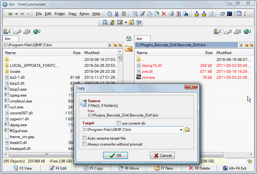

 Post subject: Re: Bar code script or filter
PostPosted: Thu Jun 16, 2016 1:03 am  (#16)
Plugin requires additional libraries (zint.exe, zint.dll, libpng15.dll) in folder Gimp 2/bin.
File zlib1.dll is already in Gimp.
I noticed another (restriction) - open file and Gimp must be on the same disk.
It needs further code changes - maybe someone will try to?

PostPosted: Thu Jun 16, 2016 1:42 am  (#17)
Posts: 2667
I got it to work but it does give me errors from time to time.

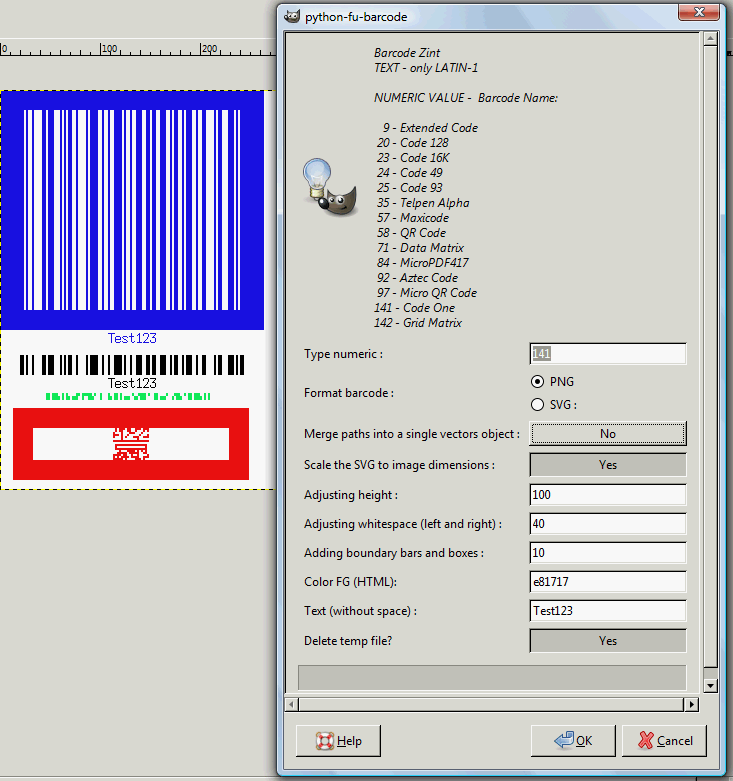

PostPosted: Sat Jun 18, 2016 2:16 pm  (#18)
A small step forward:
It works only for saved files - now uses the temporary file
Remained the problem of lack of acceptance of the spaces in the text
In menu: Filters/Render/Barcode Zint...
ps. /Edit: 20-06-2016/ Attachment deleted-it was a failed attempt to create a plugin.
PostPosted: Sun Jun 19, 2016 1:17 am  (#19)
Thinking does not hurt...
The latest version - accept spaces in the text.
PostPosted: Sun Jun 19, 2016 9:46 pm  (#20)
Joined: Jul 04, 2010
Posts: 2253
These seem to be pretty nice! A couple came up with a blank white layer, but I'll play to figure out why. I wish it would allow you to make the QR Codes larger. If I increase the size of the image, it gets blurry. SVG has been throwing some errors.
