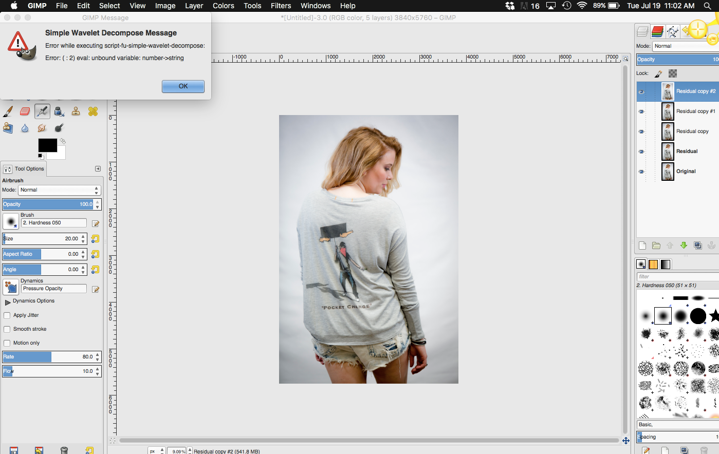

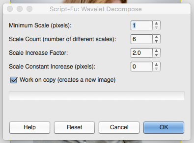

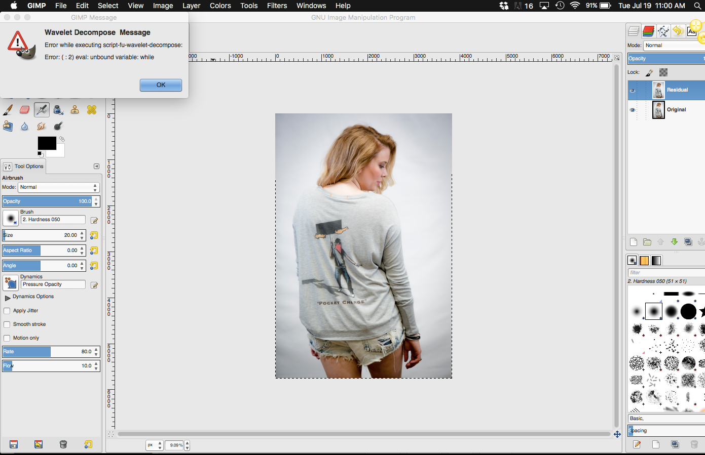

I am trying to get one filter in particular "wavelet decompose" because i have gotten it to show up on my menu bar in two sepearte placees but neither work. They get error messages. I have hear about this G'MIC plug in that has bunches of filters but don't know what it is or how to get it or what i need for it or if I will lose anything like presets and keyboard shortcuts or anyting like that or if it will look different and have stuff in different places. I don't knwo what a LINUX system is and i am on a Mac El Capitan. I would love any help anyone could give since I am having trouble with this issue for work. I have attached some photos. Thanks so much best!

Hello dlabo12. I'm running El Capitan 10.11.6 with Partha's McGimp 2.8.14 and G'MIC 1.6.5; it works great. I've "googled" the particular wavelet decomposition "script", downloaded and installed into my Gimps script folder - it shows up under Generic... There is no wavelet decomposition "plugin" for the Mac that I'm aware of.
Now to your question above, if you download the versions I've mentioned above, you'll be okay. However, there is a new McGimp/GMIC version (2.9) and if you download and install it - none of your plugins will work as the 2.9 version is experimental.
Hope this helps.
